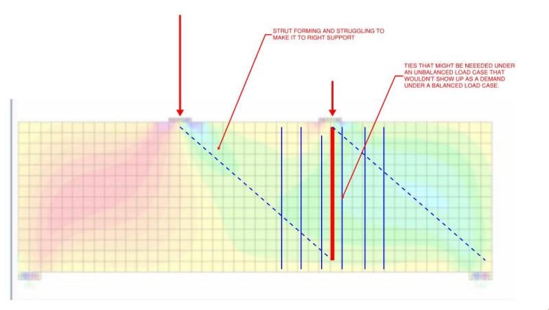

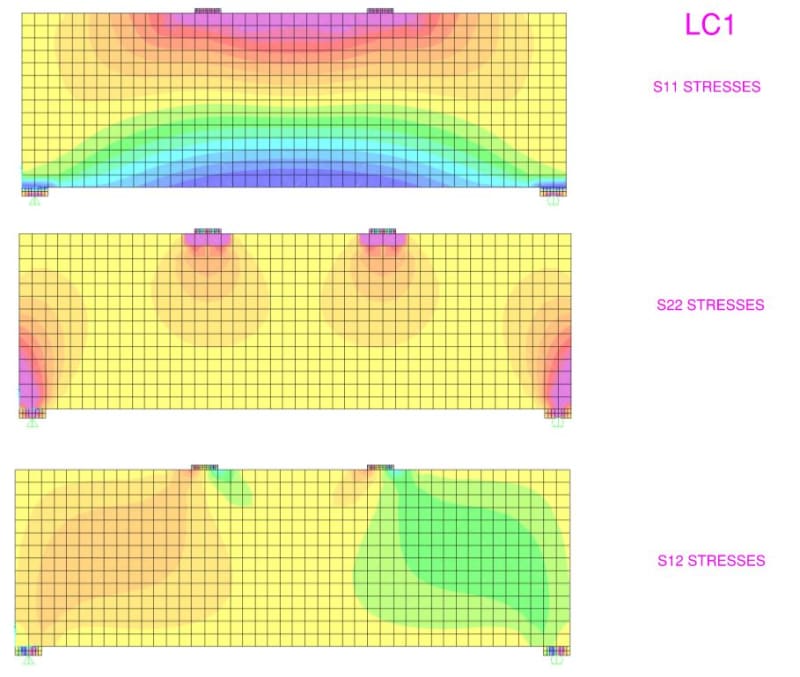

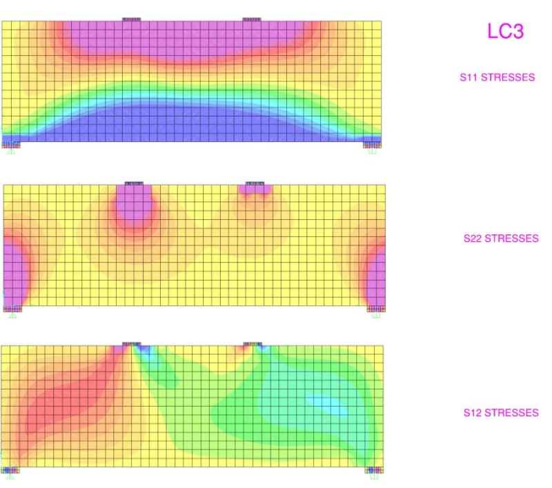

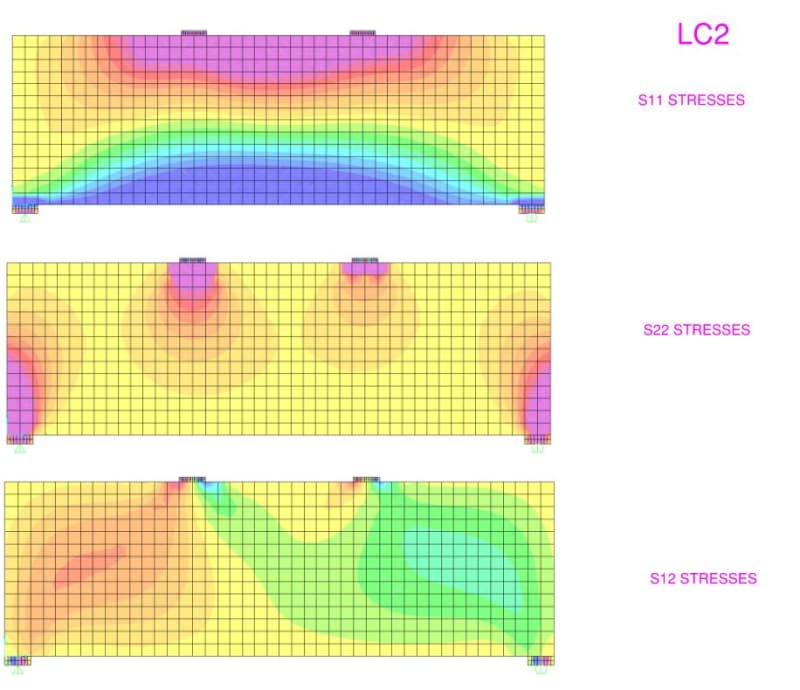

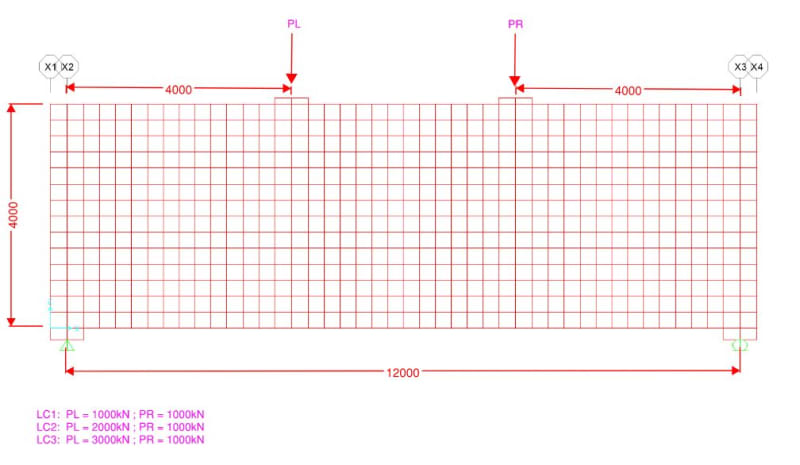

I have been re-reading Schlaich Schlaich et al Book recently, and in this they show linear stress plots to help designers get to the optimal STM. To continue this discussion I mocked up a an example focusing on the load case being questioned. This is a 12m span with two point loads that lead to disturbed regions. Three load cases were considered. P/P, 2P/1P and 3P/1P.
Of interest from Schlaich:
Definition:
LC1 Stress Plots:
LC2: Stress Plots:
LC3 Stress Plots:
I had a little time to try a STM using the defaults in a design package, so I have included them: This is not my typical use for STM, so I have to think a bit more on their defaults. Time for the real job.
Thanks for doing all of that investigation work Brad805. It provides me with a perfect opportunity to discuss something that I've been thinking about for a while with regard to unbalanced loads. Namely, that a failure to consider a significant imbalance has the potential to result in designers omitting important tie elements. Thankfully, most of these things tend to be heavily dead load dominated so it probably doesn't come up much. I can't say that I've ever seen an STM design example with more than one load case considered. I guess one is just supposed to be thoughtful enough to anticipate that need on their own.
At which point it starts to look like a beam designed the usual way but ignoring concrete contribution to shear capacity.

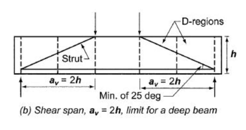

PS: the FEA model is 3:1 so isn't a deep beam according to some codes.
Brad805 and KootK analysis notably highlights that 1 STM model is only valid for 1 load case. Since STM models can be long to calculate, the approach could be to limit the number of STM Models while being more conservative with the load cases.

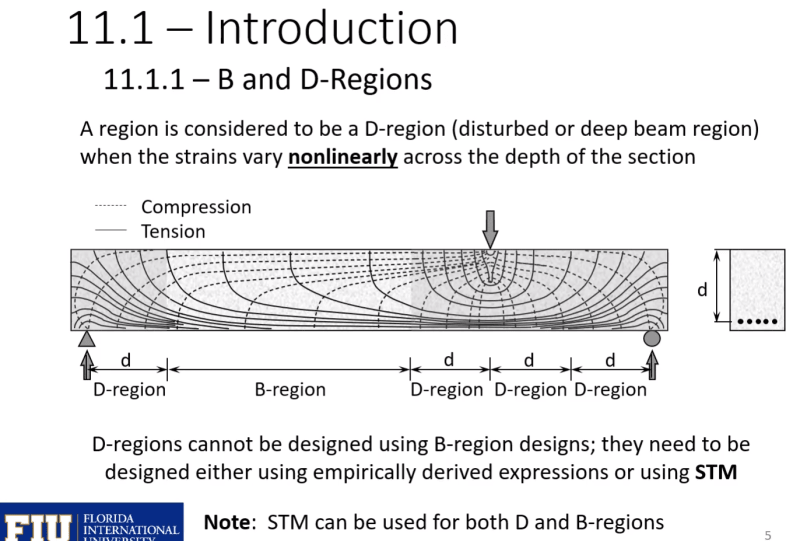

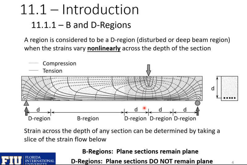

I believe the boundary strut can be very similar to an ACI flexural compression block if you are modeling a B-region using a strut and tie model. In the first example of this thread, this a deep beam, we are in a D-region and the flexural compression block formulas of ACI do not apply.
See 2:01 of this video:
gusmurr said:
I would have thought that with overlapping struts, you would at least have to assess the overlapped region in the same way you'd check a node.
You are right. Two struts crossing would imply a CCC node.
See 18:20 of this video:

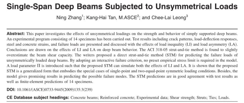

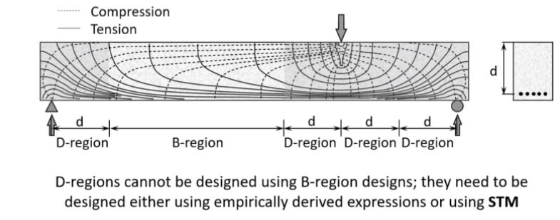

I went searching for a study on the unbalanced load question. I found one that will be of interest to those using this methodSSDB STUDY In addition to unbalance question they also considered asymmetry.
Steve, there is an interesting figure in the Schlaich report from 1987. I have included it below (avail online). I agree that the span to depth of the example beam would not be a deep beam if a uniform load were applied, but considering the point loading it has disturbed regions.
If D-region cannot be designed with B-region design, then how does normal beam design work?
Bearing loads within the span are non-event D-regions. Loading on concrete doesn't get better than that. You can make any beam entirely D-regions with enough point loads.
I have to read the asymmetric loading test report in more detail but note that they had a premature failure which they've excluded from their analysis of the accuracy of the design method. Is real world construction and loading going to be more forgiving than a laboratory?
The tested deep beams are also the usual micro scale stuff. Pretty rare to design a beam so small in my work. I wonder whether there's a scale effect. Also limited examination of variables such as the shear reinforcement.
Thanks for the clarification Logan82, I agree. That said, you'll note that I took care to not use the terms ACI Compression Block or Whitney Compression Block. Rather, I just went with Flexural Compression Block. And I contend that there is a flexural compression block in all situations. The only question is that of what the appropriate treatment of that compression zone is for a particular case being considered:
1) Whitney/ACI stress block for Bernoulli regions.
2) Boundary struts for disturbed regions.
3) The old school lever arm method that I use regularly (steveh49's point regarding simplified methods).
The notion that a deep beam isn't so flexurally deep after all is really what got the whole consideration of arching/STM rolling in the first place. It's a lesson that I've not forgotten since first learning it, I assure you.
