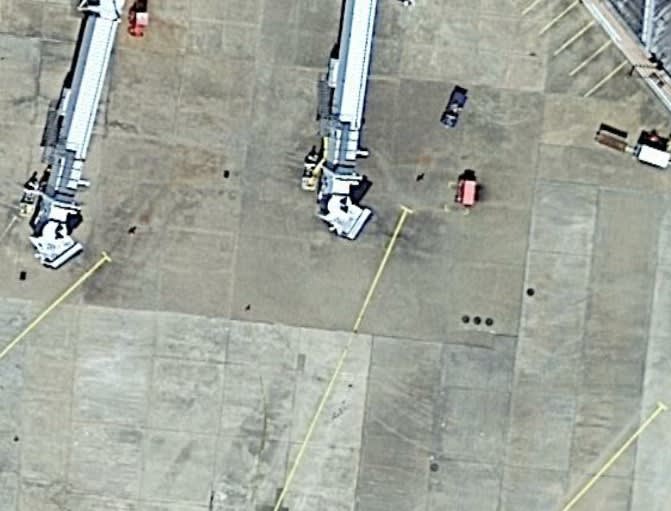

The aerials of the airport don't show good (or any) safety distances painted on the ground.
Plenty of comments below the videos from workers saying that they witnessed near misses on multiple occasions, not at this airport in particular, but others that have a similar mode of operation.

It's likely the ground power is on the air bridge under it so to get it attached to the aircraft they should come in from the nose, but if the bridge isn't attached yet then that takes them into the danger cone in front of the engine.

There doesn't seem to be a lot of space between this and the air bridge so a moments inattention to detail and that's your hole in the swiss chees gone.

Its a common course for everyone that has an airside pass be it cabin crew through to the very well paid "technicians" that drive the honey wagon aka toilet service vehicle... and some do struggle with it as they have to learn the apron markings which are extremely lacking in the picture above.
