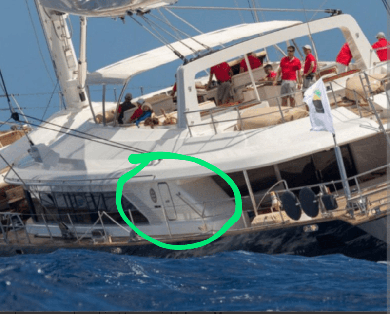

This appears to be the location of the engine room ventilation. That would certainly let water in at 88 degrees. Perhaps there is a procedure to seal those hatches when rigged for sailing. Was the vessel sailing or motoring during the storm? If motoring, these hatches would have been open.
If hit by a wave from the beam that cause them to lay over, well there is certainly a lot of glass on the side of the house.

There are also two forward doors for small watercraft to be aboard and some witnesses thought it went down by the bow; this is in keeping with an early speculation that an access door had been left open.

I can imagine that it was mainly OK dragging the anchor by the bow, but at some point the anchor line was lost, allowing the drag on the mast and forward rigging to turn the ship sideways and heel. If a forward garage door was open that would allow the door to go under, flooding the forward portion and maybe the rest of the yacht; few details on interlocks and watertight doors.

A source briefed on the investigation, however, told Corriere della Sera that divers who went down to inspect the wreck found the mast in one piece, with the boat intact — its hull unbreached, its hatches closed, its windows in place.
However, it is laying on its right side, so the starboard garage door may be open and the divers cannot see it.

Another superyacht recently sank at anchor from leaving the garage door open in somewhat mild seas so it's not an unheard of cause.
