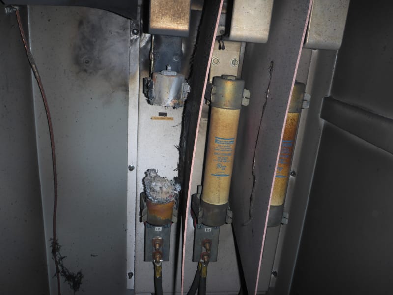

Here's what happens when you try to put a current somewhere in the range of 200A to 400A continually through a 200E fuse.
That is why E fuses are poor stand alone protection devices and should be used with a protection relay.

Somehow this feels like it is comparable to my old adage that if the inspector ever has to break out the tape measure to check clearances you don’t have sufficient clearance regardless of what is measured. In this case if you’re shaving the size of the load to be added you don’t have the necessary capacity. What if you convince yourself it really only is 3.3 but turns out to be 3.65? Do you want Lionel’s picture to be applicable to your site?
