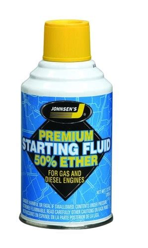

I remember my cousin, on the farm, using ether sprayed into the intake during really cold mornings.

Are there any products like this stocked in Texas fuel depots?
I haven't seen an engine started with raw 100% ether for about 50 years.
It was very dangerous to use and to store.
It had the power to traumatically dis-assemble an engine if too much was used.
It was a liquid, often poured on a rag and held in front of the air intake.
Many of the newer diesel engines use pre-combustion chambers and many pre-combustion chambers will not stand the stress of starting fluid.
Many diesel engines now have glow plugs to pre-heat the air in the intake manifold.
I have used a propane torch to heat the intake manifold as an aid to starting a diesel in cold weather.

The can I have is a spray. I need to use it to start the lawn mower in the Spring.
I have two diesel generators, two diesel tractors and two diesel trucks.
Of the six engines, only one allows the use of starting fluid.
The other five each use a combination of both glow plugs and block heaters.
As well as the block heater and the glow plugs I needed to use booster batteries to start one tractor at minus 30C to clear the driveway of snow a few years ago.
This was one of the engines in which the use of starting fluid was prohibited.
