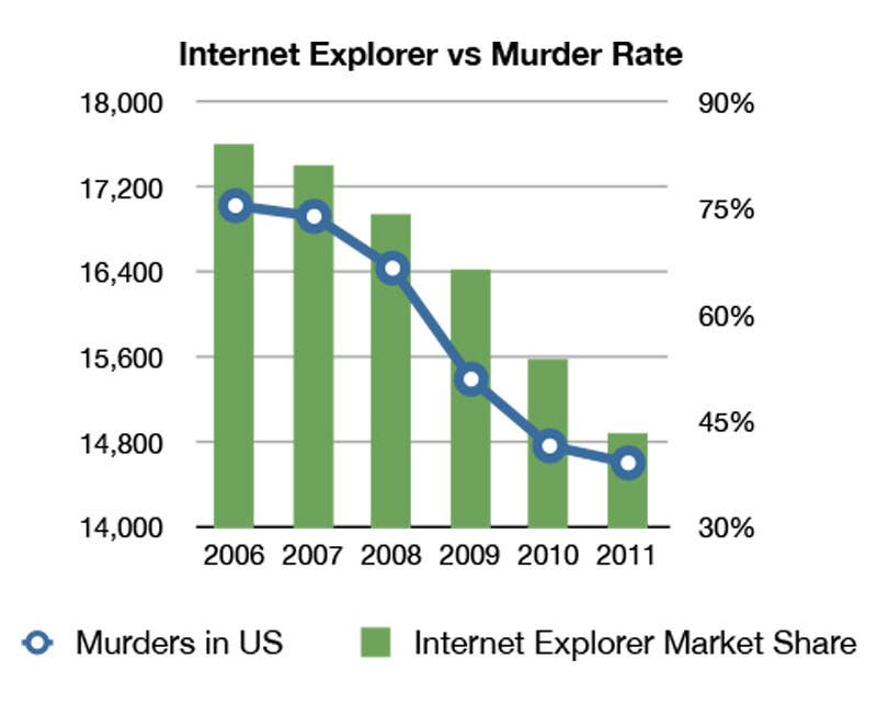

I didn't follow the nuanced back and forth positions, but I liked the Internet Explorer graphic as an illustration of correlation vs causation.

I do like your comparison at the bottom of the post. It is an absolute fact that correlation does not by itself prove causation.
Although one could argue that as the use of Internet Explorer dropped, the outrage directed toward it dropped as the user population dwindled, which resulted in less people going into a psychotic rage, which then led to the lowered homicide rates ;-)
