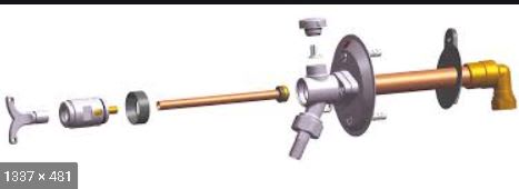

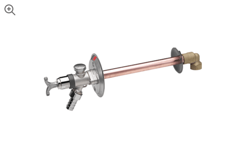

Alistair_Heaton said:
This is the outside taps we use.
That's exactly the same as what I use in South Carolina. They drain all the water outside the valve and the valve is on the inside of the wall. They're good as long as the inside of the house is a little above freezing.
I have the same thing .
