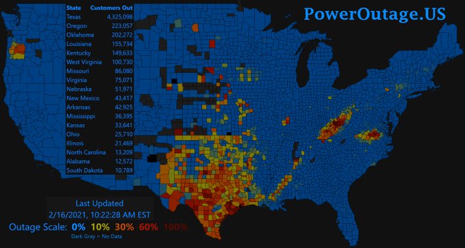

For what it's worth, this was the national power outage map for this past Tuesday, February 16th:
John R. Baker, P.E. (ret)

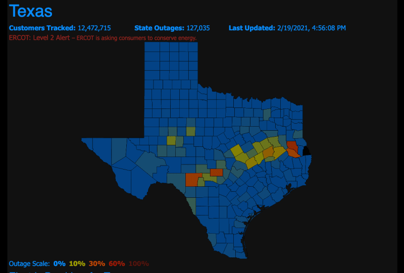

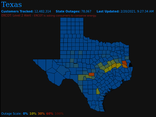

And for the current outage map for Texas, go to:
Here's what the Texas map looks like RIGHT NOW:

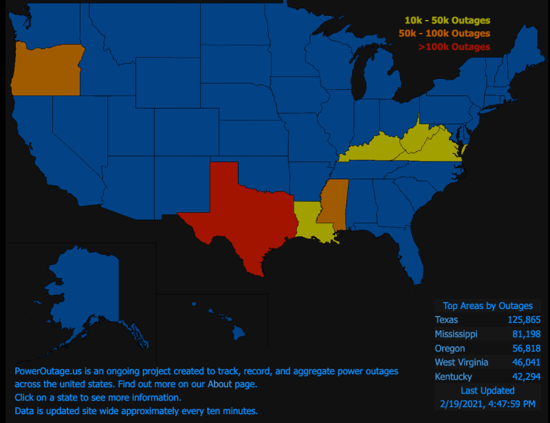

And here is the national map showing if a state has an outage and what the maximum extent of that outage:
Selecting a state will bring up a map of the state showing the status for each county in the state:
Here's the current national map:

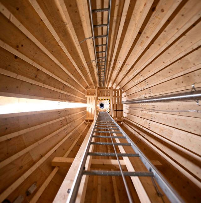

Yes and now when we are starting to build wind mills in tree instead of steel, they will be even cheaper. smile

Redsnake... is that a windmill shaft in wood?
You can't use a wood tower with the really large windmills.

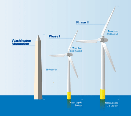

Planned construction to replace retired coal generation, 27 miles off the Virginia coast. 2 ea 6MW units on line now. The remaining construction is planned to be 180 units at 14MW ~ 2,640 MW. I guess we will see how well this works out eventually.
Fred
