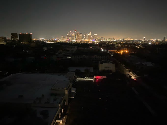

Yes, there's a bit of an outrage in Houston this morning when this image was seen on the local TV station showing, as a result of the so-called rolling blackouts, downtown Houston all lite-up as if there was no power grid problems yet the residential and small commercial businesses in the areas surrounding the city in near total darkness:
Skyscrapers lit up in downtown spark outrage amid power outages
