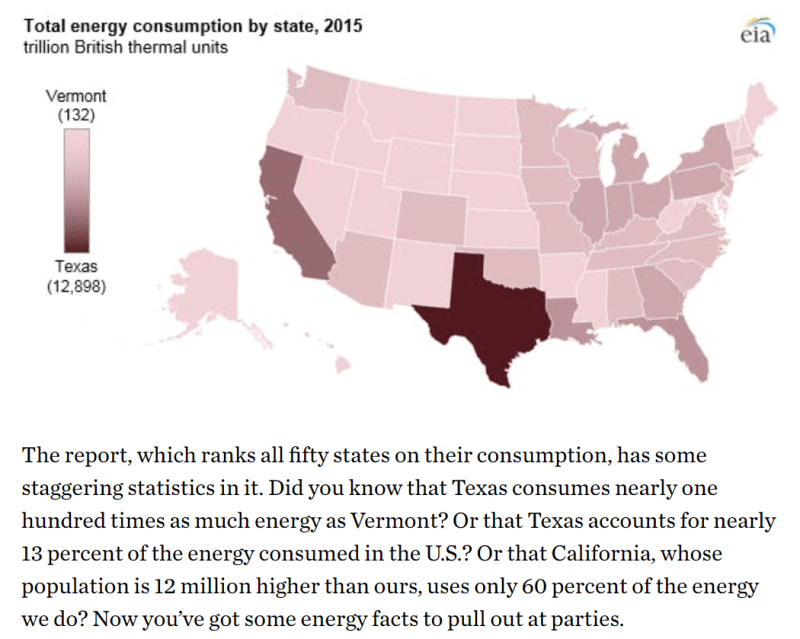

It's not enough... from the charts I've seen, a substantial part of their energy comes from 'unfriendly' sources. This will have to change substantially in the future.
I thought Vermont was still French? With a population density less than Alaska?
Dik,
You are being really disingenuous. Texas and the Gulf Coast region is the industrial center of the U.S.
Not at all... and it will have to change... for being the industrial centre... says something about the last freeze...
For the record, the population density of Alaska is 1.3 individuals/square mile. Vermont is 68.0. And for comparison, since they were just mentioned, Texas is 101.2 and California is 246.1. And before anyone asks, New Jersey is the densest populated state at 1,210.1 (of course, if Washington DC ever became a state, it would be the densest at 10,588.8) and the least dense is the aforementioned Alaska. Note that these numbers are based on an estimate of the US population made in 2013.
