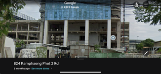

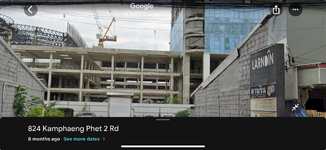

UPDATE:
With a bit of help from google earth I found a rear view of the building. There must be video out there somewhere showing the collapse from this view.1743293296100.png
EDIT AGAIN:
In this video here you can distinctly see and hear the initial collapse. You can see the building drop maybe 100-200mm, while remaining "intact" and it remained like that for another 5 seconds before the collapse.

The lower east face glazing doesn't move much initially. The ground level core east face (if that's what it is) doesn't move at all. I say if that's what it is because the roof level core appears much smaller and set back further, unless that top portion is just a reduced cap. In the end, it looks like the west core face drops first and pulls the rest of the building down with it.
