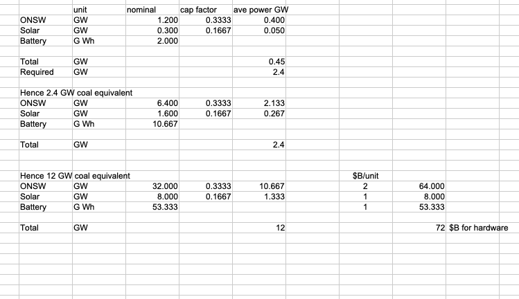

Here's my scrappy estimate of the cost to replace 12 GW of coal with this system. It still only has 4 hours of reserve. AGL is roughly 1/3 of the grid, so the cost in hardware alone for the entire grid is $B210, which will need to be replaced every 20 years, call it $B10 per year, shared among 10 million households, that's $1000 per household per year.
Cheers
Greg Locock
If there are no other associated costs then that is pretty good. My USA electric bill is something around $1800 per year. That's with all gas appliances and vehicles.
That's an additional cost. You've still got to pay for all the rest. NY's latest auction for offshore wind came in at 15 cents per kWh. No backup. That's about 10c/kWh more than you'd probably expect.

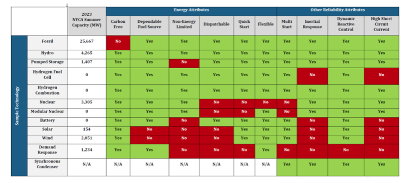

The entertaining and informative Francis has a look at New York's 'plan' to get to 70% net zero electricity in 2030, and 100% in 2040
It is entirely reliant on the development and installation of 30-50 GW Dispatchable Emissions-Free Resource by 2040. Gosh, they are just going to mandate it into existence.
Of course DEFR exists, it is called nuclear power. The UK designed, built, and activated the first ever civilian nuclear power station in 4 years. So, undoubtedly NY could hit 2040 with 30-50 GW of extra nukes. They claim nuclear isn't dispatchable to get rid of that bogeyman, and have come up with the following
Oh good. Burning green hydrogen.
How much green hydrogen is currently available? The total pipeline capacity for green hydrogen reached 174 mtpa by the end of Q3 2023.
The calorific value of 1 tonne of H2 is 33 MWh, and burning it I suppose you might get 50% efficiency so, at the moment the global supply is 174*10^6*.5*33*10^6/365/24/3600/10^9 GW=0.09 GW. (worth checking that seems comically low)
Lucky old NY gets 33300% of the current global supply. Better get legislating, lads.
Just to put 30-50 GW of DEFR generation into perspective, that's about the 100-200% of Australia's current grid. All from unicorn dust.

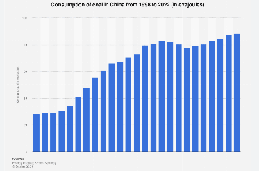

No the real fight is with China's coal powered manufacturing industries.

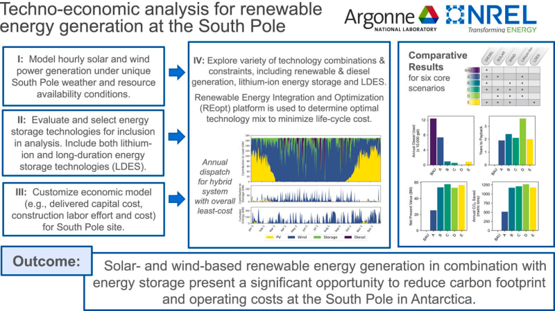

Net zero in Antarctica. At the moment the research stations are diesel powered, with the landed cost of diesel at $40 per gallon. So they've played around with the numbers and if we ignore unicorn Long Duration Energy Storage, which as they say is probably aqueous based, a tad inconvenient for Antarctica, and discovered that just like every other study I've seen all around the world, with the exception of special cases like Iceland and Norway, the most cost effective non nuclear solutions were a mix of fossil fuel peaker, battery, solar and wind. That's all described in table 6 and figure 7. The expected usage profile, based on one year of weather (danger alert, one year of weather is not enough) is in Figure 6
here's a preprint of the paper
