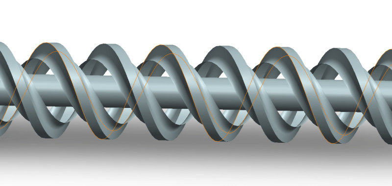

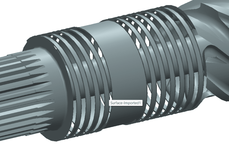

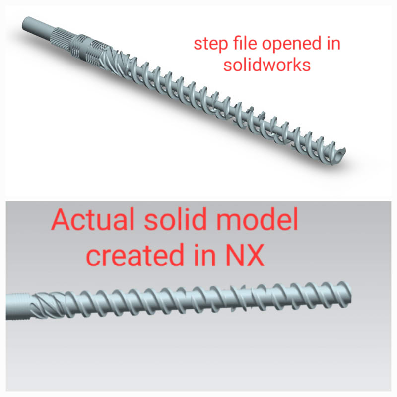

I have saved this below model as a STEP file from NX and when the same .stp file opened in SOLIDWORKS it is crashing and showing this model as a surface model cutting some hollow , is there any proper method i have to follow while saving STEP file in NX.

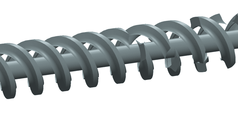

Yes after doing examine geometry i found some edge blend error surface i repaired it , then re-imported STEP file back into NX , its showing perfect geometry but when i import same STEP file into SOLIDWORKS it show me as a broken surface geometry[ponder] , but if I import IGES format saved from NX for the same file into SOLIDWORKS it shows perfect results!
I would say that the SolidWorks import is at fault at this point.

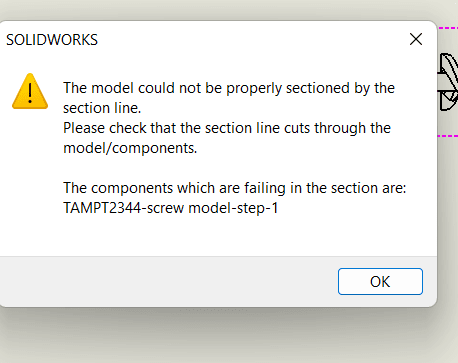

i think its solidworks fault as its still showing me same faulty results , i will check with the solidworks forum once.
