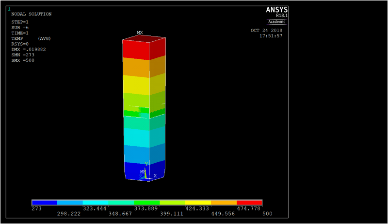

Hi all,
I'm relatively new to ansys apdl, and am having a lot of trouble with contact analysis in APDL Mechanical. I'm not able to correctly transfer temperatures between two bodies with contact elements in between them. I've attached an image of the problem, and also the txt file that I'm using. Unfortunately I need to use txt import, and not the gui or workbench. Any help you're able to give is really appreciated, as I've been struggling with this for weeks.
Hi Benjamin,
you are using SOLID5 element with keyopt(1) = 0 so you perform coupled field analysis and UX, UY, UZ, TEMP, VOLT, MAG are your DOFs. Do you want to perform such a coupled analysis? If you are interested in thermal analysis only, change keyopt(1) to 8, in your macro ET,1,SOLID5,8 or use solid70 ET,1,SOLID70 (thermal only element).
Then you should maybe define some material properties of your contact.
If you specify thermal contact conductance for you contact via real constants
rmod,cid,14,TCC
You will see results which correspond to bonded contact.
If you do not want to set material properties for the contact like TCC or emmisivity etc, use KEYOPT,cid,2,2 (MPC contact algorithm which couples the DOFs directly with constraint equations).
Regards
Petr
Petr Vymlatil (
Amazingly helpful thank you. Yes I was trying to perform structural and thermal together, as thermal expansion is a big part of the more complex model (not shown here). I'm still getting some penetration issues, but I'm now able to conduct heat through the contact. Thanks so much Petr.
Ben
If you add the following to the same part as your txt (keyopt to force) than the mech/temp contact is OK and temps are OK.
Just added as per Petr Vymlatil recomendtaions a TCC contact conduction value (same as the material, 60.5), both U and TEMP DOF (keyopt(1)), and then used keyopt (5) to close or resolve any contact gaps or initial penetration.

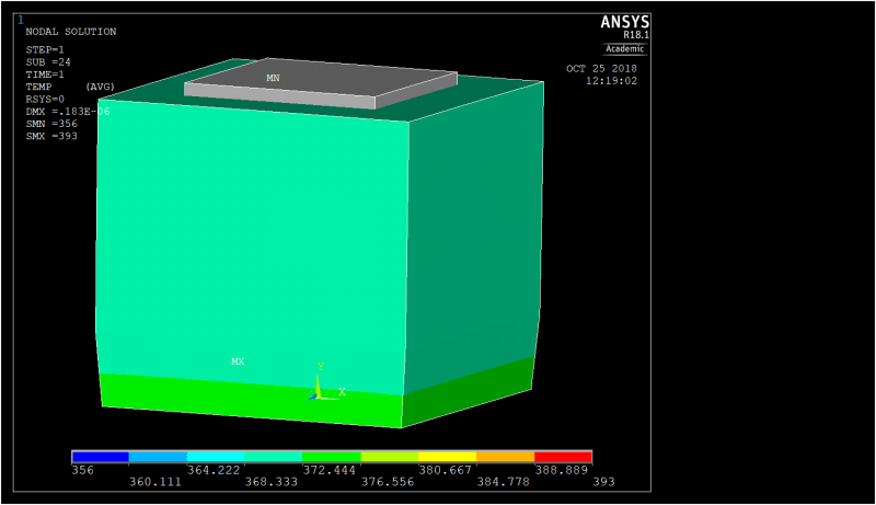

Thanks for your help everyone. This works great for my practice problem, but when I try to include it into my real code (transient, killed elements, and temperature dependent mat props) it fails again, and I'm not sure the issue. In the image, there is a penetrated layer below the solid, and it's at 356 K which means it's not transferring heat between the larger body.
Thanks in advance.
Ben
It is because of the EKILL that probably kills elements and contacts. If you take that part (EKILL) away it works fine.
I would revise that (EKILL - in your image the grey elements I think are those inactive during that step, so you do not see the results - check the contact status if it is active that will tell if the bottom half that is not killed is in contact with the big block). Also if they are connected and there is not contact you might as well, make a compatible mesh between the parts, instead of using MPC to connect dissimilar meshes. Of course if the geometry is complex it can be hard to do that, but such a simple one it is straightforward.
It is the esel, and the esel, inve that selects the contacts/targets also and then they are killed by the subsequent ekill. Try to select the top solid5 elements differently.
