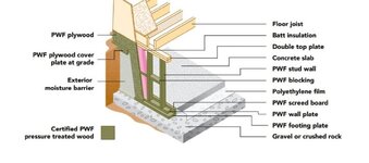

why not just give them a wood basement in the addition?
I'm glad you mentioned that as it's something I've considered. Durability aside, can you think of any structural pros or cons to doing that? I see it as pretty agnostic so far.
Plebian homes here never get geo. Not even in whole neighborhood projects somehow. I was out at a house a few weeks back where an abnormally large bathtub seems to have appreciably settled the last 1/4 of the floor plan somehow. Just crap luck being the one house where the geotech report probably would have made the difference.
Durability is the only concern I have, really. As my former boss used to say, equilibrium is equilibrium. If the forces are balanced, you're good.
The Southern Pine folks but some real effort into promoting them about 20 years ago: Permanent Wood Foundation Manual

One consideration might be that it should get you closer to replacing the weight in-kind, and thus be less likely to induce new settlement.
What I mean is that if you replace the 8' of dirt (or whatever it is for the basement) with a structure that is similar in terms of weight (really bearing stress at the new footing locations), you'd not expect increased settlement beyond what has occurred naturally at your founding level. I'd wager you would have a greater chance of the weights being a wash if you build a wood foundation. Of course, if your structure even with wood construction, is significantly heavier than the area of soil being replaced, that really is a moot point. But may be worth it to do the math to see how close the new weight is to what you're removing.
