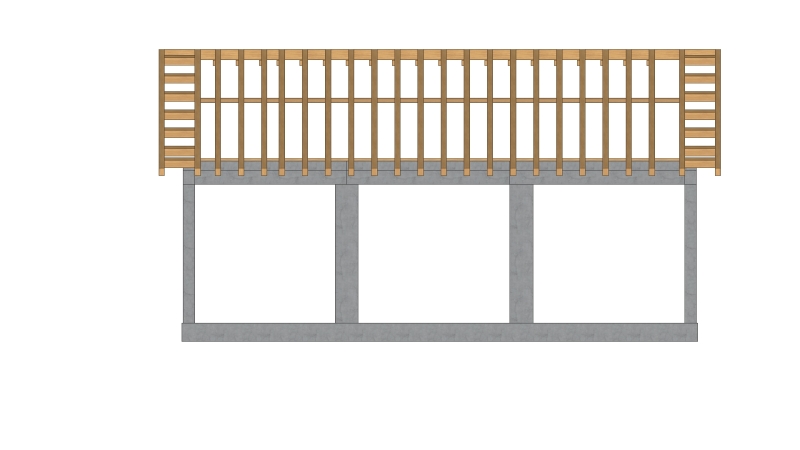

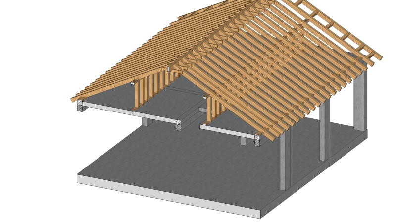

I am designing a timber roof to be supported by a RC concrete slab. As you can see from the picture the timber frame is simply composed
of inclined beams supported by timber columns that connect to the RC slab.
Now my question is, what is the best way to connect the timber columns to the Rc slab? I am thinking of steel brackets but not really sure.
KootK said:
Given the owner's desires regarding space usage, I'd get rid of the columns beneath the ridge and let the rafters cantilever up to a ridge board that is supported by the cantilevers without the posts.
Ok, therefore if i remove the timber columns beneath the ridge board, the rafters will actually carry the load of the ridge board, thanks for the advice

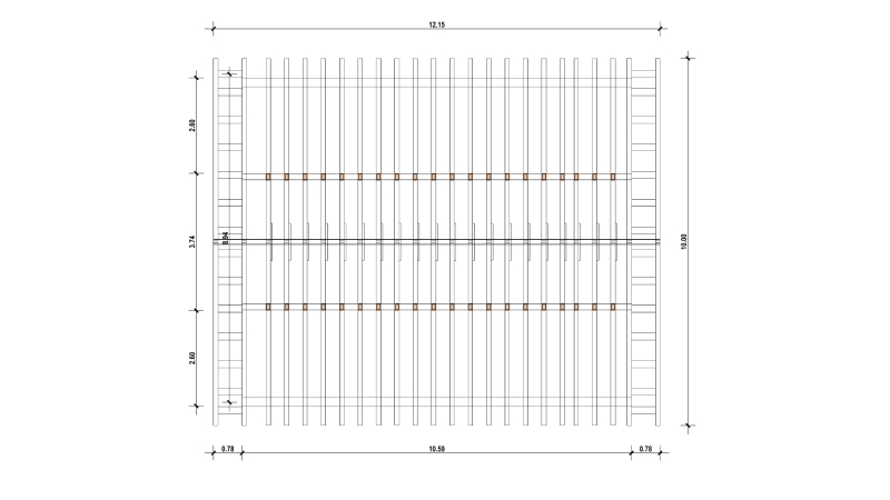

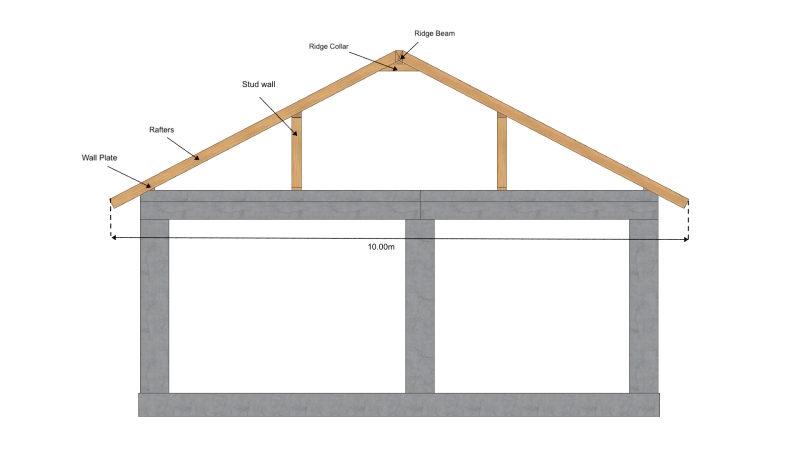

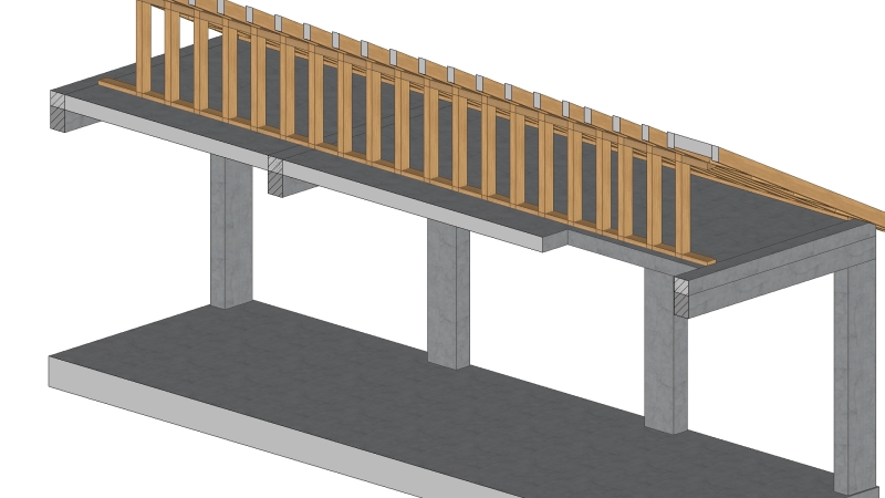

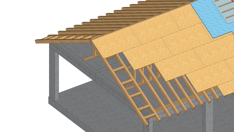

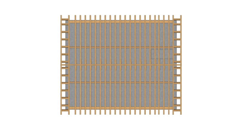

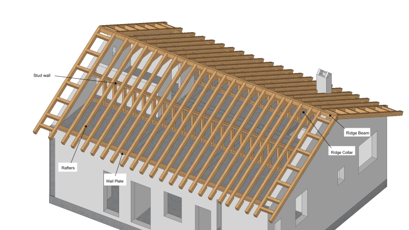

Here is my latest design of the roof, I have replaced the 2 purlins with 1 stud wall and also removed the timber columns that supported the ridge board.
I have also increased the number of rafters with spacing at 50cm.
Now the rafters are supported by the wall plate at the roof edges and by the stud wall at midspan (almost midspan), the top of the rafters cantilevers on the ridge board
what do you guys think?
Keep in mind that the design of the timber members is not finished and the section dimensions will change during the design.
also the design of the stud wall is not finished and i will probably add some horizontal bracing at mid-height of the stud wall.
I will also create some openings with a header on the stud wall for access to the outer storage space under the exterior portion of the roof.
For the gable walls I will use masonry bricks and i am also planning to tie the roof to the gable walls by either using timber bracing embedded or use some steel brackets embedded.

Makes sense to me. The gable should also be framed in timber, with the brick as cladding if desired. Typical brick veneer construction. You don't want single skin, unreinforced brick there.
I think you're there. What will the roof sheathing be in your market? If it's plywood, it would make sense to space your framing at 610 mm.

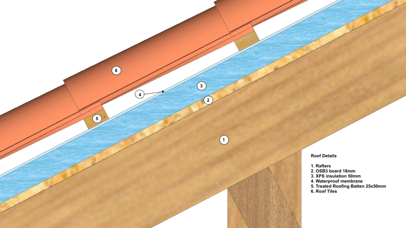

For roof sheathing I am using OSB3
Properties
8ft x 4ft
Length : 2.44m.
Width : 1.22m.
Thickness : 18mm.
Material : OSB.
Here are the details

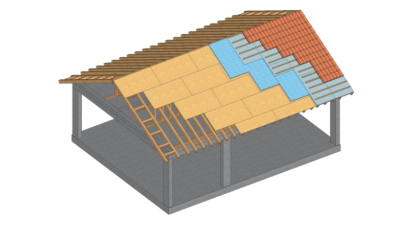

MONASTIRI_v10_-_Structural_Model_-_29_-_Timber_Roof_Design_2a_ScreenShot_23102017_185216_otubqd.jpg
I think i will need another layer of vertical battens between numbers 4 and 5 to hold the waterproof membrane down and also provide space for airflow beneath the tiles.
Why does it have to be at 610mm? Isnt the roof sheathing installed perpendicular to the rafters? as shown in the picture below?
MONASTIRI_v10_-_Structural_Model_-_34_-_Timber_Roof_Design_3_ScreenShot_25102017_105722_hyh3l7.jpg
MONASTIRI_v10_-_Structural_Model_-_34_-_Timber_Roof_Design_3_ScreenShot_25102017_110046_bnxjoh.jpg
In my area, we like the sheathing joints to land on top of the framing members. Hence the 2' spacing.
I can't really comment on your roofing system, because it is new to me. Is this customary in your country? I have never seen roof tile battens installed above rigid insulation and a membrane. How long are the batten screws to the rafters? I would be a bit concerned about the screws bending.
Ok i understand however Some manufacturers suggest installing the sheathing perpendicular to the rafters.
hokie66 said:
I can't really comment on your roofing system because it is new to me. Is this customary in your country? I have never seen roof tile battens installed above rigid insulation and a membrane. How long are the batten screws to the rafters? I would be a bit concerned about the screws bending.
You have a valid point there, I am not really sure about the system either and i have not made up my mind yet, i am still working on it, i think this is mostly used on small roofs with no access, therefore, makes it easier installing the insulation on top of the sheathing.
I was thinking that if i could use this system it would be possible to save some money by not having to plasterboard the whole roof ceiling in order to hold the insulation in place.
installing the insulation above the roof sheathing is more straightforward and as you can see all thermal bridges due to the rafters are blocked.

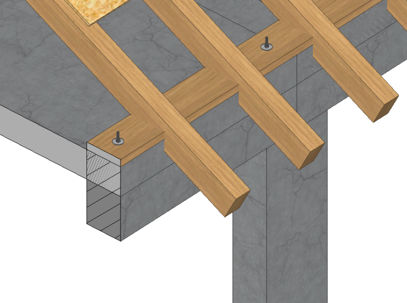

Hello guys, any ideas on how thick the wall plate should be and what spacing for the anchor bolts shall i use??
I know i should use the reaction forces from the analysis to design these but i am just curious to see what is common in practice.

Yes that is exactly what i am going with but i forgot to post an update about the spacing of the rafters.
I am using 2440mmx1220m (8'x4') boards, therefore, my spacing needs to be at 610mm (2').
When installed perpendicular to the rafters one board will span 4 openings, therefore, 4x610mm = 2440mm or if you will 4 x 2' = 8'
Wall plate and Anchor bolts
Any ideas on how thick the wall plate should be and what spacing for the anchor bolts shall i use??
I did find some info for anchoring stud walls on a concrete foundation but not for a timber roof.
it is suggested to Anchor sill/wall plates with 0.5in.(13mm) anchor bolts equipped with 0.229-in (6mm) thick, 3-in. by 3-in.(76x76mm) square plate washers.
Space the bolts from 32 in. (80cm) to 48 in. (120cm) on center. The IRC requires a minimum spacing of 6 ft. for houses subjected to wind speeds up to
110 mph, but tighter spacing greatly improves wall performance
For shear transfer purposes, wall plates 1.5" think are usually sufficient. Your detail out at the eves may require something thicker for geometric purposes though, I don't know. Bolt spacing is something that can be designed based on the load requirements.
I will probably use a wall plate of 2" (50mm) thick.

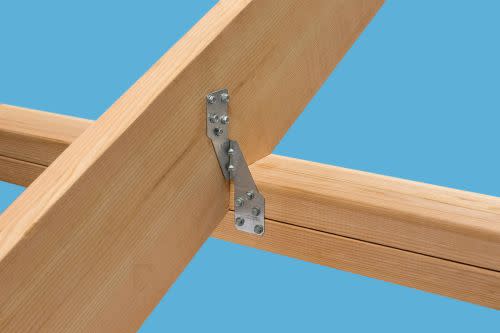

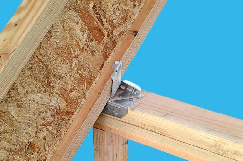

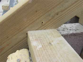

Rafters - Wall plate connection
For connecting the rafters to the wall plate, I will use a birds mouth cut on the rafter to sit on the wall plate,
then what are my options for the connecting the rafter to the wall plate?

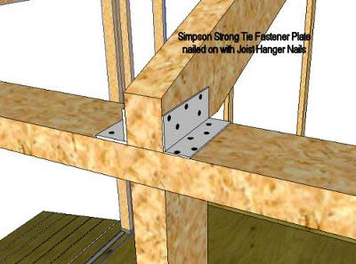

shall i use L-shaped brackets on both sides of the rafter in addition to vertical nails (at an angle) passing through the rafter and wall plate?

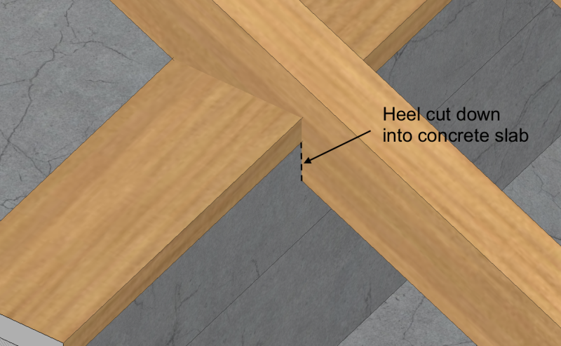

is it ok if the heel goes down into the concrete slab?
After some research These are some of the options i found out regarding RAFTER - WALL PLATE connections, what do you guys think?
I personally prefer a combination of numbers 3 and 4 ---> 3) birdsmouth cut with L-shaped brackets in addition to 4) screws or nails
1) SIMPSON STRONG TIE Rafter-to-Wall Connectors for Solid Sawn Lumber NO NEED for birds mouth cut

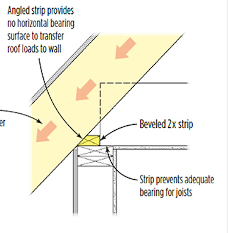

2) BEVELED WALL PLATE with no birdsmouth cut on the rafter.
3) Birds mouth cut with L-shaped brackets on both sides of the rafter
4) Birdsmouth cut with nails or screws.
5) Birdsmouth cut with h3 brackets on both sides
