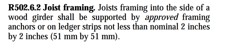

Upon reading your post, but not having a sketch to see, if you are butting the 2x8 rafters into a band, beam or packing, I thought the code requires a 2x2 nailer or hangers. I thought facenailing of any kind was no longer accepted. Am I not picturing this right?
I think @Ron247 is right. I think code generally requires joists/rafters to bear on wood, steel, concrete, or masonry, or be supported by metal hangers, but I guess if you have an engineered alternative you might be ok.

Can you point me where that is? If NDS has values for toe nailing, I don't see how that is not allowed?
It is from the IRC code. I know it is in "Floor Framing" but not sure about roof framing. Due to the loadings you cited and what I am picturing, I think building inspectors might apply it to your situation. I had an oddball roof one time and had to use them on some rafters that ran parallel to the eave between two existing supports. It was a small roof, so it was not a real issue. Also it was my own house.
I briefly looked in the Roof Framing and have not seen a direct reference whereas it is in Floor Framing. They do have some "bearing rules" in the roof framing. I don't think NDS has a rule against it.

The specific code references in the IRC (2018) are "R502.6 Bearing" for floor joists and "R802.6 Bearing" for roof rafters and ceiling joists. However, if its an engineered design with a stamp, I see no reason why toenails would or should be prohibited, although the quality of toenail connections in practice is notoriously terrible, then add to that any chance for long term deterioration of materials due to water intrusion, rot, etc. would make their performance exceptionally terrible, and I can see why the prescriptive code does not permit toenail connections, so beware.
