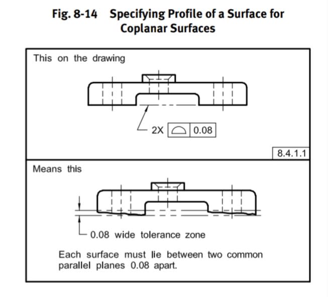

What's the best way to apply a 'flushness' tolerance to two nominally coincident surfaces? Is there a good way of doing so without needing to specify a datum?
If I understand your intent right, I think flatness with CZ will suit it better. When making one of the surfaces a datum feature, the datum plane will be established based on the high points of that surface only, so you may be missing out some out-of-flushness, so to speak, that way. Also depends on the flatness requiremet or other tolerances that may be controlling the datum feature. Anyway, it's much less straightforward. I would also suggest considering profile of a surface with CZ. It would have the advantage of being somewhat more "global" specification. I recognize it's an ISO drawing, but in ASME profile of a surface is the preferred and better established control for coplanarity. That would also be applicable in ISO (although with a different grouping method—CZ and not just "2X"), so in terms of good communication with a varied audience, profile may be preferable.

Since flatness is a form control by definition while profile does control location among other things, it is preferred to use profile to control mutual location such as coplanarity between different surfaces. Sure, with the CZ modifier there is no substantial difference and there is a workaround called CF (Continuous Feature) in ASME too. However semantically, I would say profile is more correct.
Here is an example of coplanarity control from ASME Y14.5:
Similar method is acceptable per ISO GPS, although with the addition of CZ.

CMM being required for profile inspection is a myth. You can use a height gage to inspect it like you would inspect flatness.
Profile of a surface is allowed and means the same thing as using flatness. I personally prefer to use flatness because it reduces ambiguity by explicitly defining the surfaces as nominally flat & coplanar.
