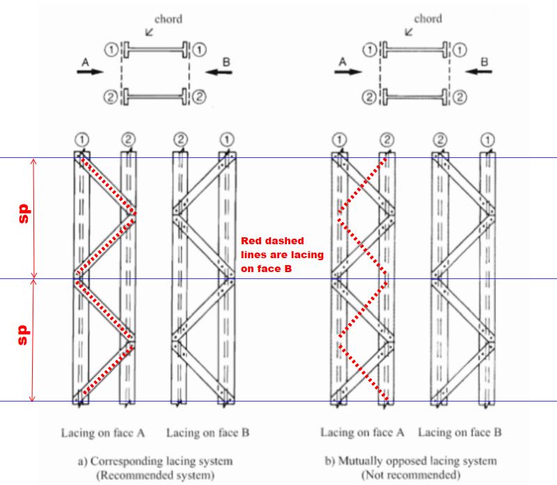

Hello,
Studying Eurocode 1993 1-1, i've found, in topic 6.4.2.2 (Constructional details), the recommendation about the orientation of the lacing planes on built-up columns shown below.
I've never used this mutually opposed lacing system but i see it in my region with a reasonable frequency and i think nobody consider the torsional effects. I'm planning to do some research on this topic and maybe write a paper about it if i verify that the reduction on member strength due to this torsional effects is too great and if there's no paper already written on the subject. Is anyone aware of such paper or has analyzed a structure of such type?
If Eurocode brings a recommendation about it and says that there are torsional effects, i think that someone has done research on the topic but i couldn't find it. Also, Would you suggest a frame analysis with the diagonal ends offset or a complete FEM analysis.
Thank you in advance.

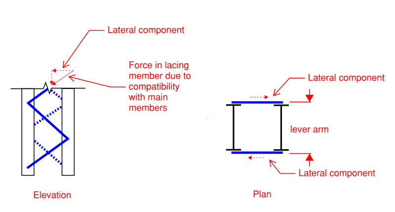

Under axial load or bending, the lacing members will carry some of the compression/tension due to compatibility with the main members.
Under pure compression or tension, if the lacing members are mutually opposed, then the transverse component of the lacing members act in opposite directions (b), giving torsion shown below.
Under pure bending, I imagine you would get the same torsion effect when you have the corresponding lacing configuration (a).
To work out the force carried by the lacing members, either check it with a frame model or I would also recommend looking at Figure 3.7 in Design Guidelines For Steel Trapezoidal Box Girder Systems, which you should be able to find online easily. Those equations are set up to determine the design loads in trough girder bracing members under bending, but it should also apply to your case. I'm sure there are probably many other design guides out there which would tell you how to calculate the compatibility forces in the lacing.
To answer the second part of your question about modelling, I would think a simple frame model with offsets would be enough. Also I would probably just treat the lacing as pure truss members.

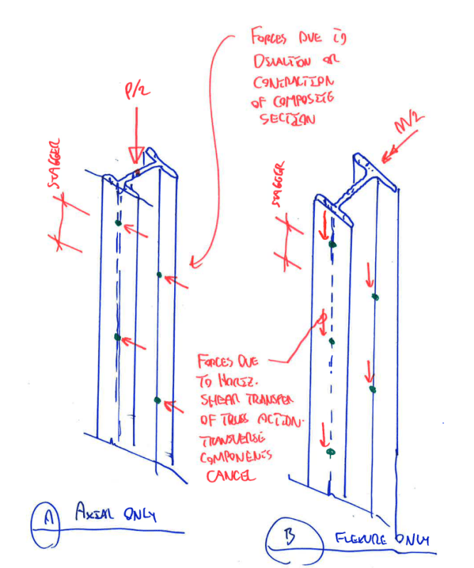

I'm with MotorCity on this one. I, also, am not seeing torsion in any meaningful sense. See the sketches below where I've considered axial and bending loads independently.
At worst, I see the torsion effect just being a local, come and go effect in the wide flanges owing to the staggered delivery of the forces imposed by the lacing. Under axial, that's torsion. Under flexure, that's a bit of strong axis bending.
My gut feel is that, if you explore this in detail, you'll find that Eurocode recommendation is a "nice to have" but, otherwise, not a very big deal. Given that there is obviously some team disagreement on this, perhaps that alone justifies the exercise of exploring this a bit.

[M/2] should have just been [M] which then imposes a longitudinal forces on the wide flanges as [M/spacing]. You know... statics and such.
The main purpose of lacing bars is to ensure that the local slenderness ratio is less than or equal to the overall slenderness ratio. The overall slenderness ratio H/R where H is the height and R is the radius of gyration of the combined section. The local slenderness ratio of the recommended arrangement in (a) is sp/r where sp is the spacing and r is (Iy/A)0.5 of one main member.
In the sketch below, members 1 and 2 of (a) are braced to a braced point of each other, whereas they are both braced to an unbraced point in sketch (b). The local slenderness ratio in sketch (b) is not readily obtained, but it must be greater than sp.
I agree that torsion is also a factor, but to me, the above argument is more compelling.
Very good observation. Maybe the slenderness ratio will be halved for minor axis buckling but will be increased for Torsional buckling. What do you think?
It may be well intentioned, but it increases the effective spacing of lateral support for both main vertical members. I agree with the British code which recommends, in effect, that the lacing members should be mirror images, not opposed.

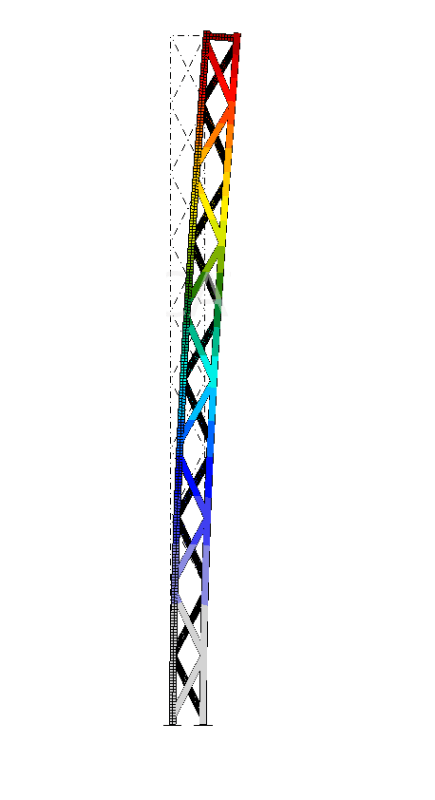

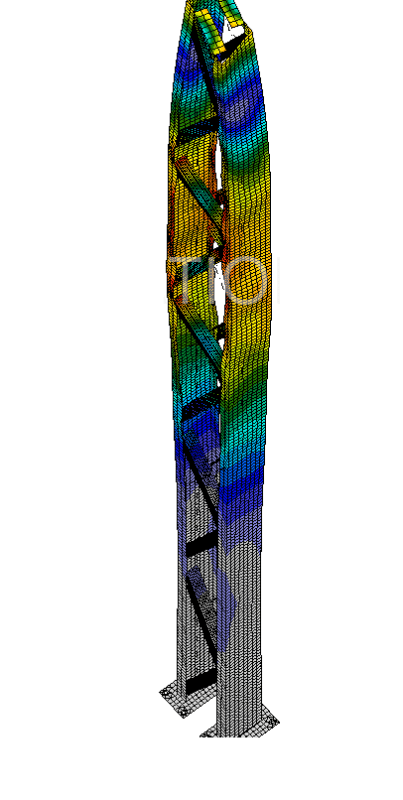

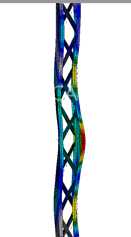

Hello guys,
I was very busy these past weeks and was not able to do the analysis about this problem, but this week i did it(Linear Buckling Analysis) and found some interesting results.
I analyzed one Cantilevered built-up column but i intend to do a parametric analysis to better understand the system. What i found from this analysis was that:
1 - The flexural buckling failure of the column was not affected by the way in which the diagonals were arranged.
2 - The column is subjected to a torsional buckling mode and for the mutually opposed lacing system, this load is smaller( About 15%) than for the parallel system. When i say Torsion, i'm referring to torsion of the combined section and not torsion of a chord. This mode of failure consists of both chords bending on opposite directions.
3 - The buckling load of the chord for the Mutually opposed lacing system was improved(About 15%), for this particular case, and consisted of a flexural-torsional buckling mode. This confirms what BARetired and Kootk talked about. If the failure mode is chord buckling on the weak-axis, the not recommended system may be better, but its difficult to determine this load.
