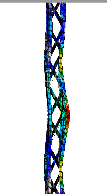

Hi Lomarandil,
I'm soryy for the late response, i did what you suggested, especially because the buckling load of the chord wasn't matching the analytical calculations and i found that the connection has a great influence on the buckling load. This is what i found.
1 - The first buckling mode for all models was Out-of- plane buckling and it was almost equal to all, as expected.
2 - The second buckling mode was In-plane buckling and, for the welded column, the value was close to the one obtained using the formula present on timoshenko`s "Theory of elastic stability". (keq=2,07, instead of keq=2)
For the bolted column, the buckling load was much smaller. (keq=2,45)
This load was not sensitive to the diagonal direction.
3 - The chord buckling was much greater for the welded connection.
Bolted connection/ Parallel diagonals:
keq = 0,96
Bolted connection/ Crossed diagonals:
keq = 0,85
Welded connection/ Parallel diagonals
keq = 0,61
Welded connection/ crossed diagonals
keq = 0,56

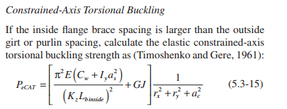

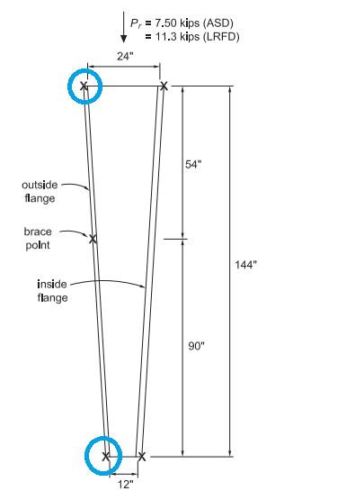

Hello,i did some research to try to find the buckling load of this buckling mode below.
The AISC design guide (Frame Design using Web-tapered Members) presents a method to calculate Constrained-axis Torsional buckling and i found the situations close. The equation presented by the design guide is shown below.
When i apply the equation for my particular case i found a good agreement. The distance between nodes(Lbinside) is 120cm and i found a load equivalente to Lbinside = 115cm, which could be explained since the bolts are closer than the nodes. The situations are not exactly equal since for the truss, these points on blue circles in the image below are not braced.
What do you guys think about this approach?
Maybe i'll change parameters to see if the load keep in good agreement with the equation.
