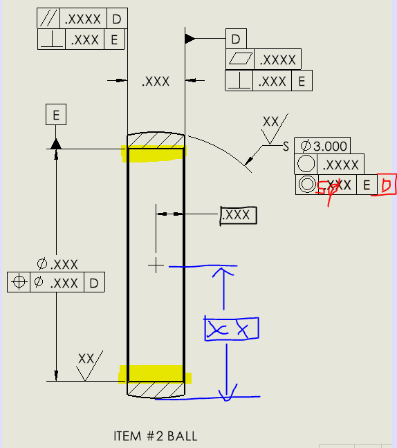

This was done by someone who I cannot reach out and ask. I am trying to make sense of his measurement drawing, it's not easy since I am a noob as well...
It has 3 axes as datums A, C and E, I am pretty sure that's not correct, one axis (datum C) should be enough IMO.
Also, none of the TP callouts have basic dimension.
Moreover, calling TP on the ball dia does not make sense to me.
Calling two flatness on the race seem to be not needed, especially if both surfaces are controlled by perpendicularity already.
Is form control on the ball OD a good idea?
My tiny brain got mixed up between the midplane and the center point in the horizontal direction, the center point would be on the midplane only if it's perfectly symmetrical. So if there is no such dimension from datum D to the center point, the spherical surface might turn out to be something like this:
I am still trying to process what a profile callout with datums look like in terms of differentiating between the other callouts.... might have to come back to this one later

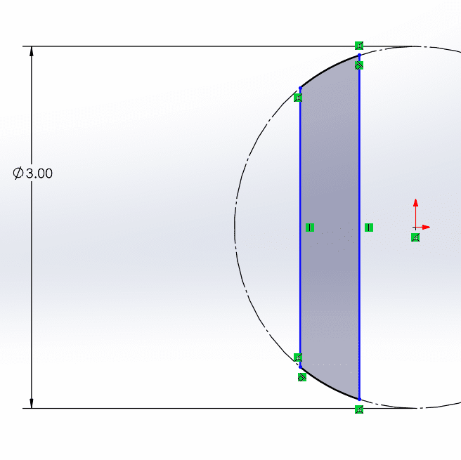

Concentricity with respect to datum E basically compares it's derived median points to the spherical tolerance zone centered on datum E.
And without additional constraints this tolerance zone can float relative to the part freely right and left along the datum E axis, allowing approval of a spherical shape as you posted on 20 Jan 23 21:43. You do have an additional, separate requirement for location, but that directly toleranced (+/-) location of the sphere's center is ambiguous about how the center point should be derived.

rollingcloud,
Currently, the shape of the concentricity tolerance zone in your figure is undefined. A concentricity tolerance zone can be cylindrical or spherical. A diameter symbol (⌀) preceding the tolerance value would indicate that it is cylindrical, but it is uncommon to define a cylindrical zone for the center point of the sphere. To indicate a spherical zone, the spherical diameter symbol (S⌀) has to precede the tolerance value. It is only possible to define the location of a true center point/plane/axis/ or true profile and the corresponding tolerance zone relative to datums by basic dimensions, and doing so is only meaningful if the corresponding datum features are referenced in the geometric tolerance that governs this location.
So to fix the previous concentricity callout, it would be something like this?:
Based on paragraph 1.4(k) of the 2009 edition, we can assume the hole is coaxial with the spherical surface, hence datum E is going to be centered automatically, so the blue dimension is extra and should be deleted, correct?
rollingcloud,
Yes, this would locate a spherical tolerance zone in the datum reference frame, coincident with datum axis E and at an exact distance of .xxx from datum D. In that tolerance zone, the median points of the sphere controlled by concentricity will be evaluated. You are correct that centering is implied and the blue dimension is redundant.
The size of the sphere, ⌀3.000 basic, is uncontrolled.

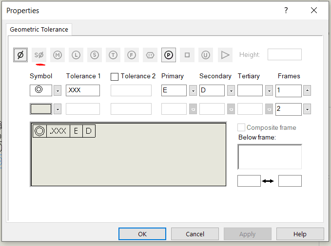

I just noticed that in solidworks, spherical diameter symbol is not allowed in concentricity FCF.

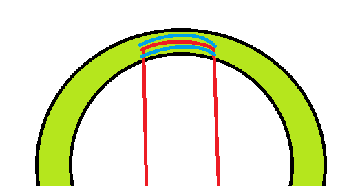

On the original drawing, the tolerance zone created by the basic sphere diameter (red), profile (blue) and TP (green zone) is like the following?
I agree with you and other CAD packages have the same limitations.
In ProE I can add manually SØ (even the S symbol is not pickable)
