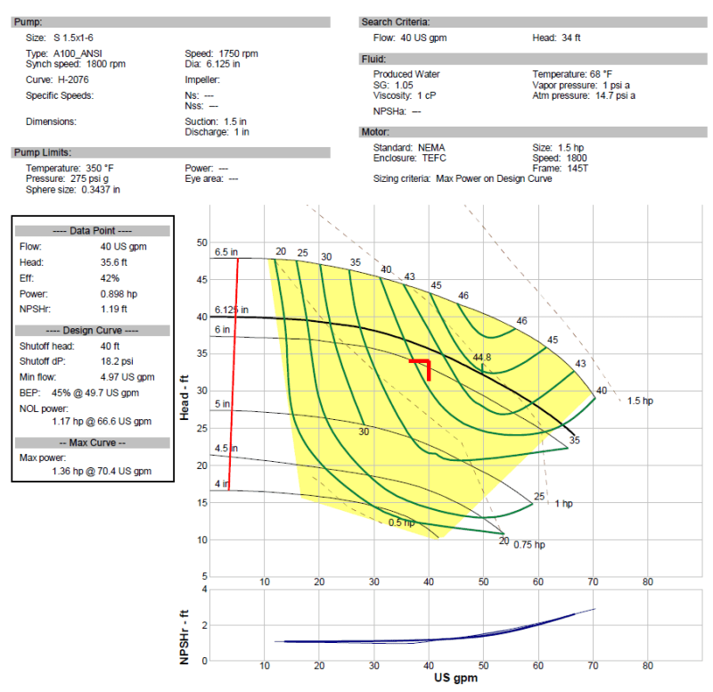

I am considering the below pump that I got as a budgetary quote.
As you mention to give it as much pressure as I can reasonably afford and I've seen rule of thumb to aim for 25 psi for triplex suction; if I set a desire to put 60 ftWC on the suction flange of the injection pump and accounting for minor frictional losses of a conservative 1 ftWC. a TDH of 60 ft wc + 1 ft wc (Hf) - 26 ftWC (Est new NPSH at minimum tank level) = 35 ft wC should put me in a good place.
I think the pump below is putting me in a good spot with a 6.125in or 6.5in impeller, no? I will go back to the vendor to see if there is a better pump that could operate closer to BEP, but I think this is a good start? This should provide well in excess of the plunger pumps flow requirements with NPSHa >> NPSHr with room to grow and the required addition and modifications would fit within my budget.

Be careful here as you seem to be mixing NPSH ft which is essentially absolute pressure, with guage pressures.
So if you want 25 psig at the pump suction then you're going to need at least that at the pump discharge flange. Forget about NPSH at this point.
It looks like at min level in the tank you only have 1.64 ft head so less than 1 psi inlet pressure which more or less matches your calculated frictional losses.
So to get 25psi at the pump inlet flange ( sounds a good plan to me), your pump needs to deliver a differential pressure of 25 psi or about 57 feet.
This piddly little pump is only doing 35. You need a bigger pump.
At this level don't fixate on BEP. The efficiency here is horrendous, but it's only going to be 1 hp or so so don't fret too much. Small pumps are not efficient.
Fair point, my bad as I'm fairly sure the other thread I read was 25 psia, so I took at as a straight head conversion from NPSH. It's taking getting used to thinking of TDH, differential head, NPSH, and their respective pressures for sure. I'm overcomplicating it at this point.
Just for my own understanding: the pump I showed above WOULD work here as it is delivering NPSHa > NPSHr for the injection pump, correct? The only discrepancy being that we are adding additional head (35ft to 57ft) in order to meet the rather arbitrary 25 psig on the injection pump suction flange as additional margin of safety. I suppose i'm getting too granular. For most experienced folks then to spec this pump we know we're gonna meet NPSHr on the booster from our previous NPSHa calcs, we know we need whatever 15-25 ftWC to meet NPSHr for the injection pump, and we know that 25 psig is a good safe suction pressure for triplexes this size; so take 1.5-2x your plunger flow rate and take 25 psig (or higher if desired for safety margin) minus any positive static head for your and run with it?

Yes it should work but if you're going to put a pump in put one in that has a bit more pressure. The benefit if positive pressure (i.e. above atmospheric) is that you can install a pulsation damper if required.
Flowrate is up to you to determine. Its best not to oversize your inlet pump too much as you have a margin from your rated flow of 20-30% before you run off the curve and if you run it too low you can run into trouble. But otherwise yes your description is about right.
You always need to look at efficiency and power as some companies will off you 30% and others 60% for the same duty, but don't go too much on BEP until you get >30hp is about right.
