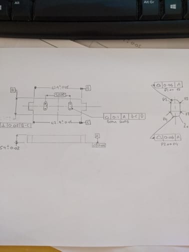

Hi ,
I have a couple of queries about the sketch i did .
Datum feature C would this be a derived line between the two axis of the radii at each end of the component
The True position call out ± 0.05 to Datum feature C , is this a valid call out ?

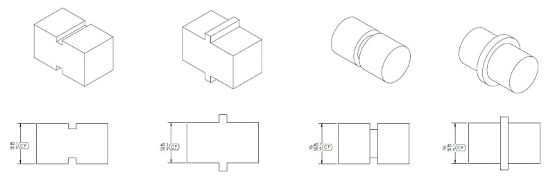

chez311, I know that the standard (at least the 2009 version) does not prohibit using CF on features interrupted by protrusions.
I just consider it a bad practice.

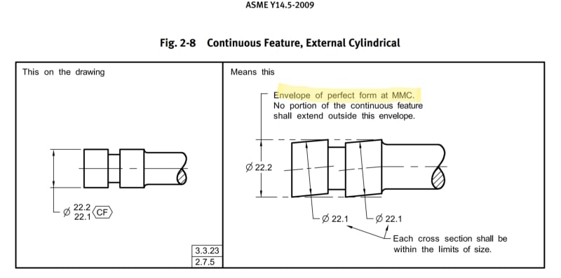

I notice that people treat CF as only a way to say "treat these X features as 1 feature" but they forget or don't know that it is actually a specific geometrical requirement with an intent that is not necessarily appropriate for every case where the designer decides to communicate that sentence with a symbol. As I mentioned (and I didn't see it addressed in the thread you linked to), the standard requires that the continuous feature must conform to rule #1 by fitting within a single continuous MMC perfect form envelope (see the figure below). Rule #1 itself is the most general and basic way to ensure fit under worst-case assembly conditions between mating parts (although not stated so anywhere in the standard). Applying rule #1 on several separated surfaces simultaneously makes sense for example for a shaft with slots that is designed to entirely fit within a single bore in a mating part. It makes much less sense for features with protruding interruptions.
From the practical standpoint, if for example it will be desired to make a hard gage for rule #1 inspection for the 42.9+/-0.05 width in the OP which apparently has a CF symbol applied to it ( not shown in the sketch but mentioned somewhere in this thread), the gage will reject the part. Perhaps this is less of a problem with a CMM or some other advanced metrology devices and software aids, I don't know. But I think anyway that application of requirements should be carefully considered, and it is not likely the case here.

Relation of CF with rule #1:
"no portion of the continuous feature shall extend outside this envelope"
It doesn't say "no portion of the part". The envelope applies only to the surfaces/features to which the <CF> feature applies.

Please see attached image , would this be an acceptable DRF.

Rwelch9,
A few notes:
-the perpendicularity tolerance on the width D should be removed. To evaluate this requires the issues discussed above in establishing a UAME for this feature (or parallel elements).
-I personally think a double leader from a single profile tolerance accompanied by 2X would be sufficient for the 2X radii. Your method is not wrong, just a little unwieldy, but I see why you might want to since they are tangent. The 2X and leaders would make it pretty clear though that the tolerance only applies to the radii. It might even be worth considering applying this profile tolerance all around this profile though.
-A should probably be the width as previously suggested.
-the "BOTH SLOTS" notation could be simply replaced by 2X in front of the FCF

Regarding what i now placed as Datum D , looking back through your discussions with Burunduk, could i use to parallel planes pushed up against the radii as Datum feature simulators. ?
I will incorporate your other suggestions also.
R
chez311 said:
The perpendicularity tolerance on the width D should be removed.
I haven't been following this discussion closely, but maybe the thinking here was to maintain the relationship of the datum features to each other. The profile tolerance of 0.1 references A, B-C, D so it's good practice to use GD&T to relate D to the higher-order datum B-C.
In a similar way, I might even suggest something to relate datum features B and C back to A, although I know this will clutter up the drawing some more. Just my thoughts...
John-Paul Belanger
Geometric Learning Systems
Yes, this is how you have it specified (width as a datum feature).
Thinking back to your response about the issues with validating a continuous feature <CF> with your software, it seems more like you have issues with continuous features in general, not just ones that pass through a protrusion? Or perhaps ones that consist of multiple planar features specifically - which of the below would you have issues with?
JP,
I agree that may have been the intent, and in almost every other instance I would agree relating lower precedence datum features to higher order ones is not just good practice but required. This is because the features themselves which are utilized as a datum feature must be sufficiently accurate and controlled back to those of higher precedence. In this case you have a width which is derived from a feature which already has a tolerance back to these higher order datum features (radius profile to |A| which should probably be |A|B-C|). Evaluation of perpendicularity of this width results in an unstable UAME with no minimum, it seems to me this is unnecessary. As discussed previously D should not be referenced primary for this very reason.
I agree with this. Also now that I look at it, the tolerances that make up the radii should probably to |A|B-C| not just |A|.
Controlling the radii for profile of a surface with reference to |A|B-C| (or |A|B| if CF is applied) will eliminate the need for perpendicularity control shown in the last sketch. That's why I suggested it in my post from 15 Jun 20 02:39 and repeated the suggestion on 16 Jun 20 09:53. It was also repeatedly suggested to designate the 5.9 width as the primary datum feature (of size)-A.
chez311, as far as I know, many experience issues related to CMM inspection dealing with concepts that were developed with fixed gages in mind: surface interpretation of MMC tolerances, datum shift, fixed boundaries of any kind, I'm not surprised by the difficulty with rule #1 for a continuous feature, especially with external interruptions.

Then how do you intend to inspect that no portion of the interrupted feature violates a single continuous MMC envelope?
