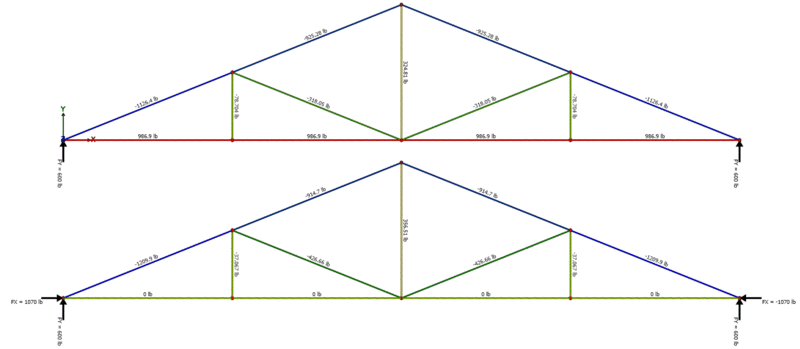

As an illustration, here are the DL reactions from a 30FT truss, 2FT o.c., 20 PSF. The second model (pin-pin) yields 1070 LB/truss of outward force = +500 lb/ft down the support line. Where does this theoretical load go? Again, belt and suspenders?
The key to this is not to focus on the load but, rather, to consider the axial elongation of the truss bottom chord and use that as a barometer as to whether or not you feel that you really have a problem worthy of explicit consideration. As Dave mentioned, take the bottom chord elongation, divide it by two, and that's how much the tops of your walls would need to be able to move in order to NOT generate the load that concerns you under extreme loading. In a flat bottom chord truss, that movement estimate ought to be fairly small.

You can estimate it yourself. For either a steel joist or a wood truss, it's a pretty easy thing to:
1) Estimate the bottom chord tension.
2) Make a conservative guess as to the axial stiffness of a probable bottom chord (L2x2 or 2x4).
3) Estimate elongation.
Alternately, you can use a truss model like the one that you posted above to estimate the anticipated movement.
I'd not intended the suggestion to be something that you'd necessarily do on every project but, rather, an exercise that you might do once or twice to convince yourself that this is not a reason for concern in many practical situations.

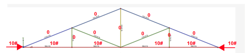

I'm not so sure I agree with 3) above, assuming all joints are hinged and the bottom chord is flat. A horizontal load applied to each end of a flat bottom chord affects only the bottom chord; no other truss member is affected.
If a flat-bottom truss is connected by a pin to an infinitely rigid foundation at each end, gravity load will not cause a problem, but a temperature increase may cause buckling. One end connection should permit sufficient horizontal movement to allow free expansion of the truss.
BA
Not so my friend. Model up a common truss, apply a horizontal load to the bearings, and watch that load spread throughout the truss according to stiffness.
It's analogous to saying that an axial load applied to the bottom flange of a steel beam never makes its way to the top flange. The shear transfer is just less efficient in a truss and you'll have upward flex in the mix.
You have me thinking now, KootK. With a beam, I agree that the load is eccentric, so there is a constant bending moment which stresses other parts of the beam, not just the bottom flange. But with the truss shown here, by the method of joints, no member other than the bottom chord can be stressed when a horizontal load is applied to each end of the truss.
For example, the bottom half of the top chord cannot have stress in it as it would imply a shear in the bottom chord which cannot exist. Similarly, members other than the bottom chord cannot be stressed, using standard methods for solving trusses. With a 10# load applied at each end, all members have 0 stress except the bottom chord which has 10# force in every panel.
