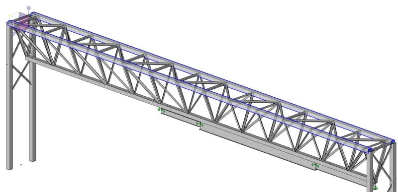

In working through the design of a (3) dimensional truss with an inverted triangular cross section and a span of nearly 100ft, what would the unbraced length of the (2) top chord compression members be? Is it accurate to consider the unbraced member length the distance between the diagonals, in both the Lz and Ly directions? Or do you have to consider the unbraced member length the entire length of the truss? Or perhaps the answer is somewhere in between, using the distance between the diagonals with a multiplication factor? Note: The roof deck will not help in this situation, as it is a remodel intended to remove columns below, and the roof deck is to be suspended below the truss.
Does anyone have any recommendations of good texts or papers to read on (3) dimensional truss design / box truss design that might address this, or anything else I'm not thinking of?
PhamENG - The link works if you slice off the [] and img from the ends.
StickengNerd -
In this case, I suspect that the diagonals are sufficient to braced the top chord in each direction. Though this is a case where (if I assumed that lower unbraced length) I'd use the Direct Analysis method and some lateral notional loads to see if the P-Delta analysis caused any problems.
JoshPlumSE-
I applied a horizontal line load along the top of one chord. It had almost no effect on the deflected shape, or stability of the overall structure. P-delta doesn't appear to be a problem so long as the columns are horizontally braced. I suspect that I can use the lower unbraced length of the distance between the diagonals, but as of yet, I haven't found anything to justify that assumption, other than basic engineering sense and experience.
You can absolutely do that in my opinion, and do it based on engineering sense as you say. Sometimes I fear that we've gone so far down the automation path that we no longer have the ovaries required to trust our own, sound instincts. Long before concentric trussing failed to adequately brace your chords across a panel, you would experience:
1) Axial strength failure of the webs or;
2) Unacceptably high shear deformations in the truss (effectively a sway column condition).
The problem is sort of self solving in that respect.

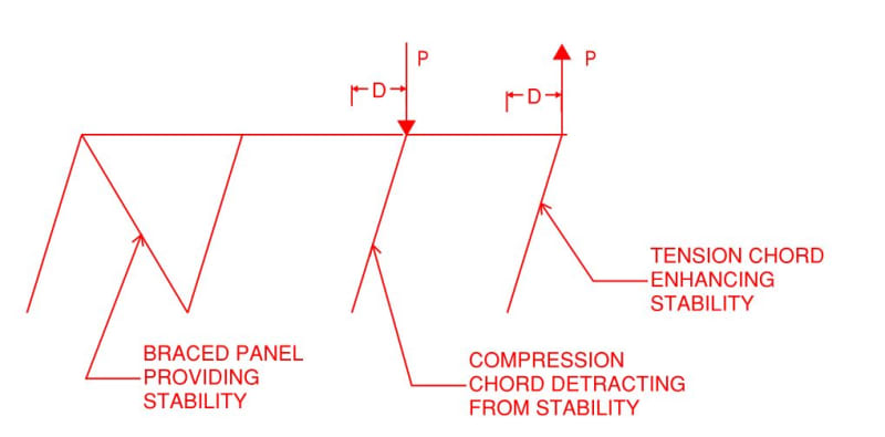

@JoshPlumSE: I'd like to discuss the two statements below. The first is from this thread; second is from an older thread: Link. We disagree on something quite fundamental here so it should be interesting to hash out.
JoshPlumSE said:
For a truss, you still have P-Big Delta and P-Little Delta. The panel joint deflections are the "big delta" effect and the chord curvature between panel points would be the "little delta" effect. It's analagous to a braced frame turned on it's side.
I submit that there is no such thing as P-Big Detla on a transversely loaded truss. The reason for that is that there is no net-compression on the cross section taken as a whole. The sketch shown below shows what I feel would truly be an analogous, braced frame situation. And it has no P-Big Delta. Or, more precisely, it has P-Big Delta demands that cancel out as I submit that they do with a truss. I could have put the loads on the frame itself rather than on the two lean too columns but I often find this presentation more salient.
