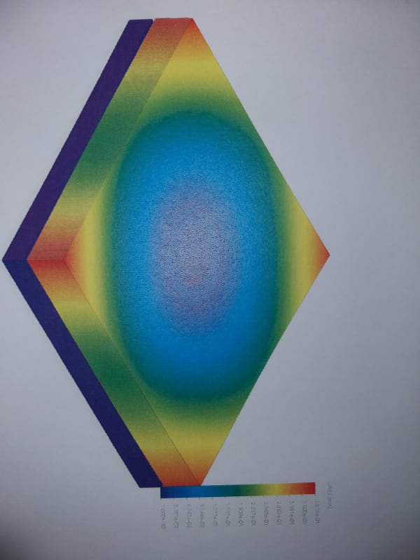

hey 3DDave - I am attaching a report of the analysis. please look at it and say what you think.
I marked with a red pen the places that may be relevant.
The photos are little blurred, but let me write down the important data:
Preload=1500 N
External Force=780 N
Fb=1580.6 N -> External force taken by the bolt = 1580.6-1500 = 80.6 N.
Fm=801N -> External force taken by the members = 1500-801 = 699 N.
I can't send the zip file with the analysis because it was run in my office's computer and I have no access to it.

Gotta say, that's the worst digital copy I've ever seen.
Without displacements there is no telling what the stiffness of any element is. We already knew the forces, so this adds no information.
I'd reduce the plates to 10mmx10mm and rerun it. It should make no difference to the typical load sharing calc unless the simulation is assuming the full square of material, far from the fastener, is compressed by the bolt.
It's good to do a sanity check like this when the results seem so abnormal.
Bad photo...it's there.
Never mind, nothing good will be achieved from this hard copy 🤣

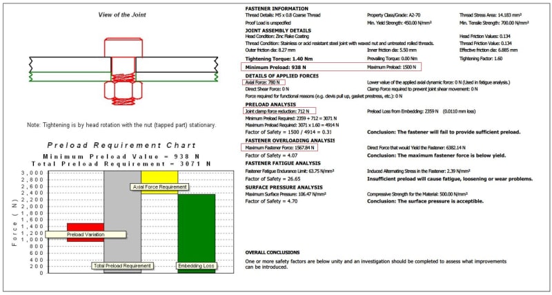

OK, here is an update - I got the help of Bolt Science calculator.
I am still confused and can't understand how most of the load is taken by the members.
You can see that the out of 780N the joint bears 712N. I have no explanation how it is reasonable.
I couldn't see what you specified for the plates (1 SS, 1 plastic) ?
