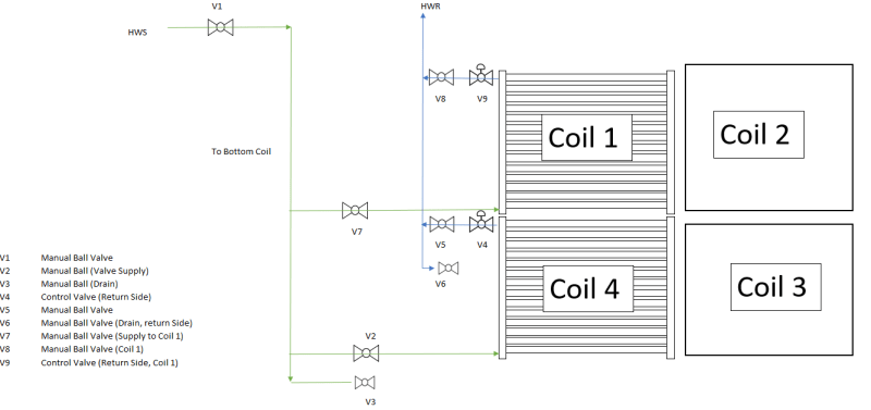

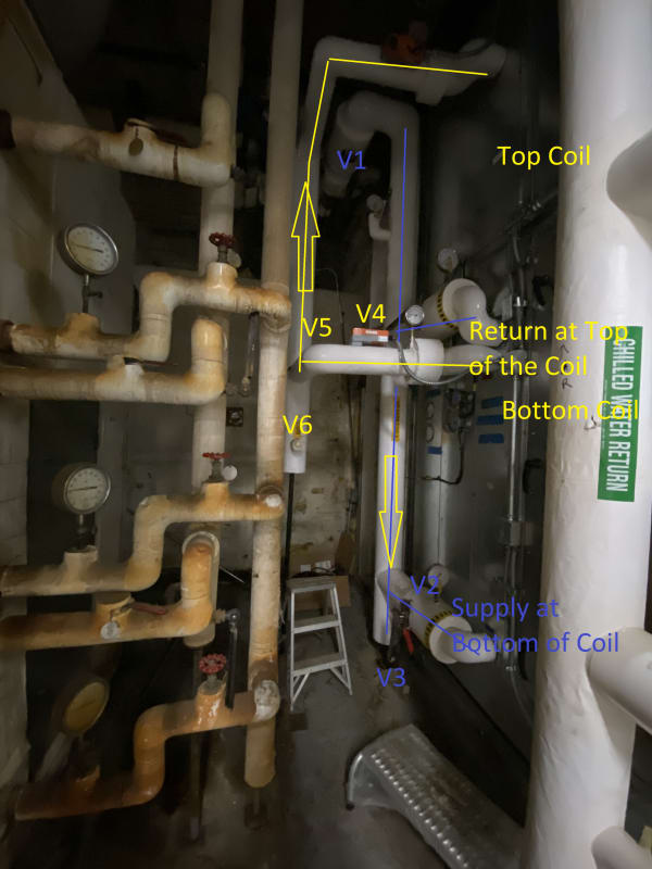

Thank you all for the responses. I will try to address all the questions here. The piping for the coils is shown below.
@immsk
Has there been a water audit done to see what the actual flow rate and pressure drop through the coil is compared to the original design?
I am not aware of such a study performed for the coil.
Do you have photos of how the coil is piped? Supply connection location/return connection location?
Yes, Please see below
Please note that the IR picture initially posted is for the coil number 4 at the bottom of the arrangement. The same issue is seen on coil 3.
How was the coil flushed? Can you describe the process.
Basically they drained the water-glycol mixture from the coils and refilled it. From talking to the plant mechanics, I understand that a back flush was not performed.
Lastly,was a chemical pipe cleaner run through this system at some point? Asking because I ran into a situation once where, the client ran pipe cleaner through the system and all the gunk/debris ended up getting trapped in the coils.
Not to the knowledge of the plant mechanics

So is your thermal image just of one coil, or is it of both coils?
@BronYrAyr
The thermal image is for the bottom coil marked 4 in my previous post.
If I understand this right your issue is not at full flow when it's all at the same temp, but only when you try and regulate / reduce the water flow?
What type of valve is V4? If its a butterfly then you won't get much flow under 30% open.
As said earlier, unless all your coil valves are on the same opening percent, you might be starving the lower coils of flow.
Do those coils have side by side vertical headers for flow and return? It's not easy to see on your first picture what the piping arrangement is between the coils and the headers.
Are you able to measure actual flow vs what the coil is designed for?
There should be a strainer on the HWS piping upstream of the coils. There should be a manual air vent valve at the top of each coil and automatic air vents at the high point of the HWS and the HWR piping above the coils. There should have been plugged tees at each coil offset HWS and HWR piping to allow blowout of each coil. Confirm pressure drop across each coil is the same to confirm equal HWS flow across each. Confirm airflow is uniform across the coil face and not concentrated at the bottom. If the fluid is not glycol solution consider putting freeze protection pump across bottom coil to operate when outdoor temperature is less than 33 degrees F.
