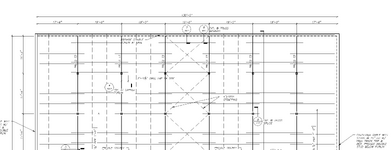

Typically, the standing seam roof is designed to float. You really shouldn't count on it for bracing or for diaphragm action (unless it's a through fastened system or has testing done per S908). A couple of good documents are AISI D111 (https://scholarsmine.mst.edu/ccfss-aisi-spec/235/) and the attached pdf. For bracing the purlins, I have seen this type of bridging used:
I would use a "lapped purlin" design so you can count on 2x the section modulus over the support.

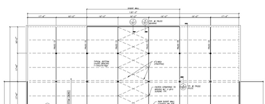

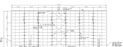

For diaphragm bracing you could also use a discrete/truss system. Here is a snippet from a truss project:
Bottom Chord Plan:
Top Chord / Roof Plan:

You still need to provide bracing for overall stability (wind and seismic) in addition to the local bracing of the purlins. Perhaps, the purlin bracing will do both but it is something to check.
PEMB manufacturers do usually add purlin bracing when using standing seam roofs to help with flexural capacity of the members.
You can find erection details for Nucor (one of the large PEMB manufacturers) online. While sizes aren't listed, it can be a good starting point look at how the system works.
Agreed.
And to clarify the X-bracing down the center in those drawings was your diaphragm truss if I remember correctly.
