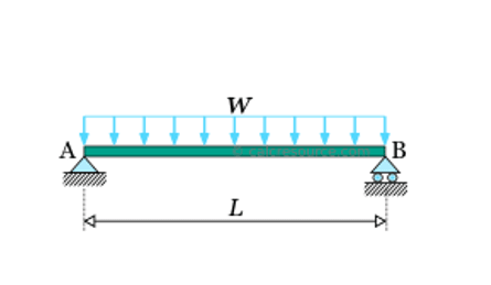

I am interested to know as to :
1. How to calculate unsupported Tube length of a Heat Exchanger Tube for comparing with TEMA Unsupported lengths.
2. How much maximum deflection of Tube is allowed for the unsupported length.
In response to your questions:
1) I would use the methodology of ASME B31.1 (Come up with either an allowable stress or max deflection and use a simply supported beam method
2) Be aware that TEMA HX unsupported tube lengths consider the effects of tube vibration as well as "imperfect" (loose) support conditions at tube support plates. Your question "What is the maximum" depends on many factors ...

1. My question 1 is seeking a method to calculate max unsupported length of the Tube for comparison with TEMA
I am thinking like:
i) Consider TEMA unsupported length for a particular Tube MOC and size.
ii) Consider the Tube is simply supported over the unsupported length.
iii) Consider UDL with Tube metal weight + Fluid in Tubes with in the unsupported length.
iv) Taking the properties MOE , Moment of Inertia, calculate the max deflection from the Beam formula for UDL as (5/384)*(w*l^4/E*I).
If this method OK,
2. My question 2 is how much deflection is allowed.

DK44, baffle type, spacing, need for tube supports, etc is normally determined by thermal and hydraulic considerations. Heat transfer and flow chacteristics within the shell. Determined during rating of the exchanger. These things determine the unsupported tube length. It may also be affected by any fixed tubesheet calculations of tube compressive stresses.
If I undestand your proposal it is to calculate the maximum span based on gravity loads. No offense, but a waste of time in my opinion. Other considerations dominate.

1. Yes r6155. This what is in my mind. Hence the beam formula sighted by me can be used to calculate deflection I suppose.
Is the UDL composed of self weight of Tube in the span + Fluid (say Water)content in the tubes?
Is permissible deflection 1/3 Ligament as Edstainless indicated?
