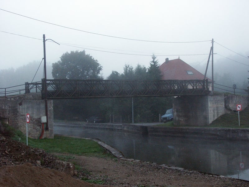

That was a Bailey Bridge, probably surplus from WWII. The last Bailey Bridge I saw was in Niderviller, Lorraine, France, over a barge canal:
September 2004 (Minolta DiMAGE 7Hi)
