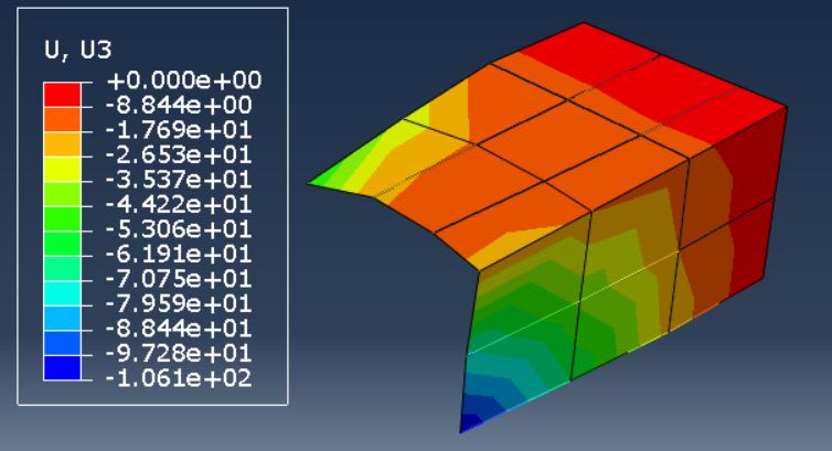

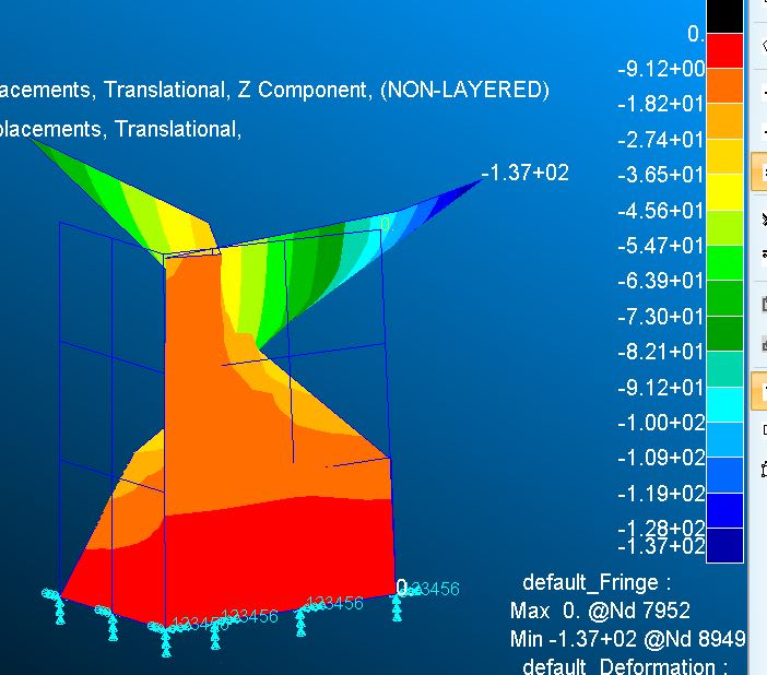

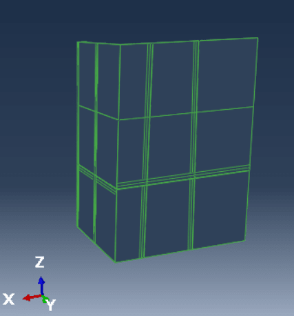

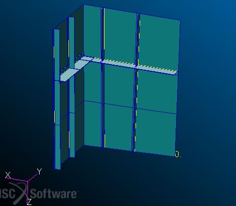

My model consists of a shell and BEAM with a cross section L. I only solved for selfweight to validate the results. You can find the attached input file below and the results from NASTRAN and ABAQUS.
MSC NASTRAN software
ABAQUS software
How about posting a pdf or jpg so folks without NASTRAN and ABAQUS can comment?
Without seeing it, my first question is: Have you compared the program output to a simple problem with known results from manual calcs or textbook example? If your problem is more complicated, then back up to an easy problem first.

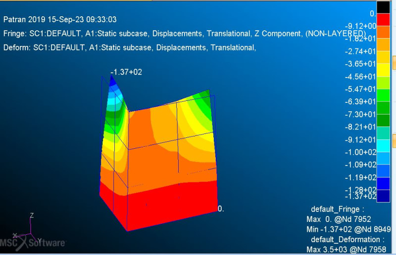

I'll point out that the two output plots look like they are oriented differently relative to the direction of gravity.
My opinion on this:
1) Don't start with comparing the FEM contours. Instead, start with comparing joint deflections, joint reactions and such. Also, can you force the scale of the deflection plot to be in the same range?
2) If the joint reactions and joint deflections are approximately the same then you know the models match pretty well. It becomes a discussion about how the contour algorithms work. Maybe even how the elements orientation defaults could be different.
3) I suspect you're going to see the joint reactions going in different directions based on those two plots.
Which of the two is correct, or at least close, based on a manual calculation?
I'd compare the two codes using a single element patch test ... different element geometries, different loads ... see how the elements react.
that MSC pic looks "wrong" ?

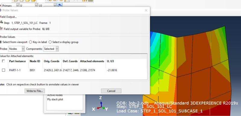

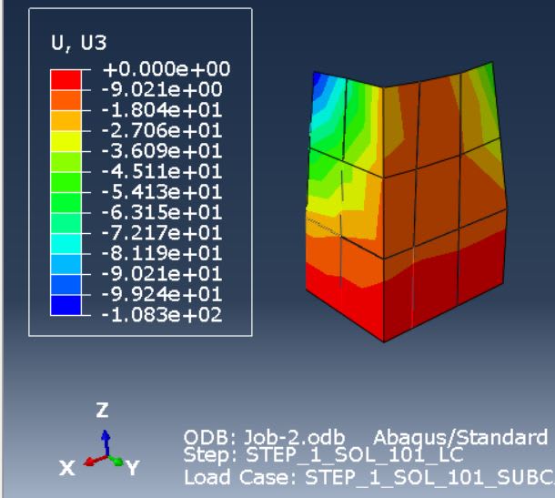

I apologize for not being clear in describing the results above. You can see the image below because I am using a BDF file from MSC NASTRAN to import into ABAQUS, so there should be no difference between NASTRAN and ABAQUS in terms of settings and force directions.

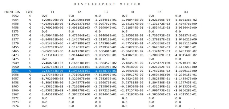

Displacement at NODE 8951 in MSC NASTRAN = -18.6387mm.:
Displacement at NODE 8951 in ABAQUS = -21.0616 mm:
Output displacement Z direction in ABAQUS:
Output displacement Z direction in MSC NASTRAN:
The displacement at node 8951 differs between the two software packages, even though I am using the same BDF file. So, I believe there might be some differences between MSC NASTRAN and ABAQUS that I am not aware of. I am aware of the difference in shell elements, specifically S4 and S4R, and I have tried to adjust them, but the results still do not match.

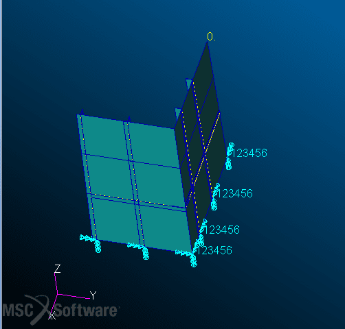

My mistake for not carefully providing information to everyone, I checked the model information before posting on this forum:
Before posting my question here, I made sure to match the data between the two software regarding mass, center of gravity, net force, and moment.
- ABAQUS and NASTRAN models have the same mesh.
- CBEAM elements are both first-order BEAM elements., SHELL element is S4
- Constraints are the same between the two software packages, and I only solved for selfweight (GRAVITY).
- AND I IMPORTED THE BDF FILE FROM MSC NASTRAN INTO ABAQUS, SO THE SETTINGS FOR BOTH MODELS ARE THE SAME.
MODEL IN NASTRAN:
MODEL IN ABAQUS:
Your figure shows the text "Sol 103 (Frequency"). Is this an eigenvalue analysis for modes of vibration? You will get more useful answers if you explain the analysis type(s): linear static, non-linear static (geometric, material or contact), linear or non-linear dynamic, modal analysis etc.

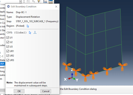

Hi centondollar ,
My figure shows the text "Sol 103 (Frequency"), which is unrelated. I just took a screenshot to show everyone the model with a cross-section, boundary constraint in ABAQUS. Can you please take a look at the attached .inp file above?
I posted on the forum because I'm new, and I don't have much time to read the manuals for both software packages. So, I posted to see if experienced users could suggest what I should do. Your suggestions could be very helpful to me.
