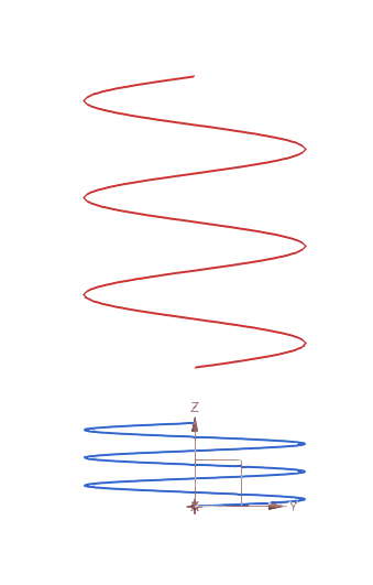

i want to connect 2 helix using third one. it must be one turn and be tangent to both red and blue helix curves
i tried a few hours and applied trigonometric functions but didn't find solution
is it possible to design such helix in between?

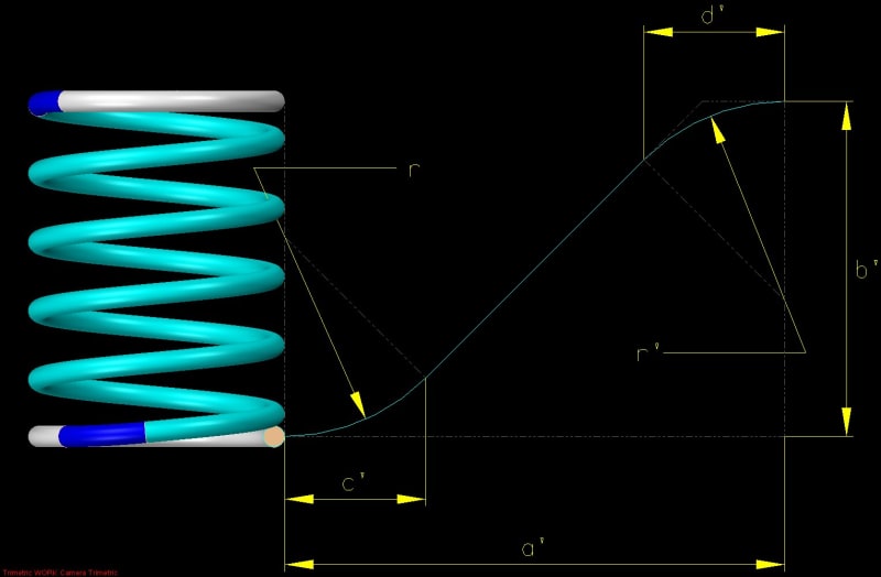

I built in the past
something like that 3 lines and fillets
but the problem was the fillet size.
its arbitrary ?
I call it : filling fillet.

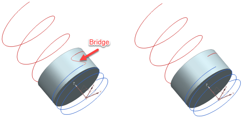

You could do something similar with the Bridge Curve. Create a Cylinder the same 'size' as the spiral and after creating the Bridge Curve, Project it to the outer face of the Cylinder.

With bridge command the problem is that endpoints of helical curves are in same polar coordinate and they are on top of X axis. So bridge won’t create appropriate curve and projection is not applicable to form a turn. please correct me if i did wrong.

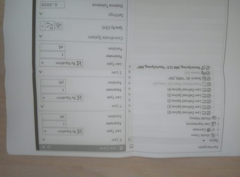

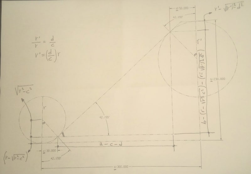

I was interested to find a mathematical solution for creating this helix. Before this I modeled another helix with law curves that could be controlled with some parameters and quickly updates. It’s a good candidate for product template studio.its illustrated below.
I find that the use of math can bring the best results. but new model is too complicated for me yet to build suitable equations.
Other more close to your needs
is here in photoes.
after I'l find the part I'l post it.

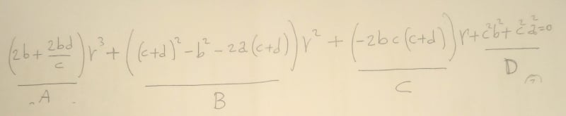

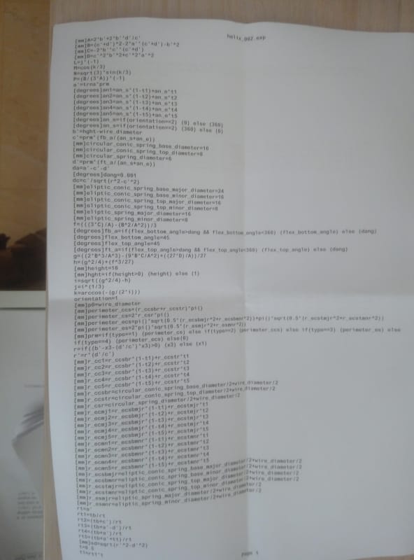

As you see in the firs picture ther are 5 equations.

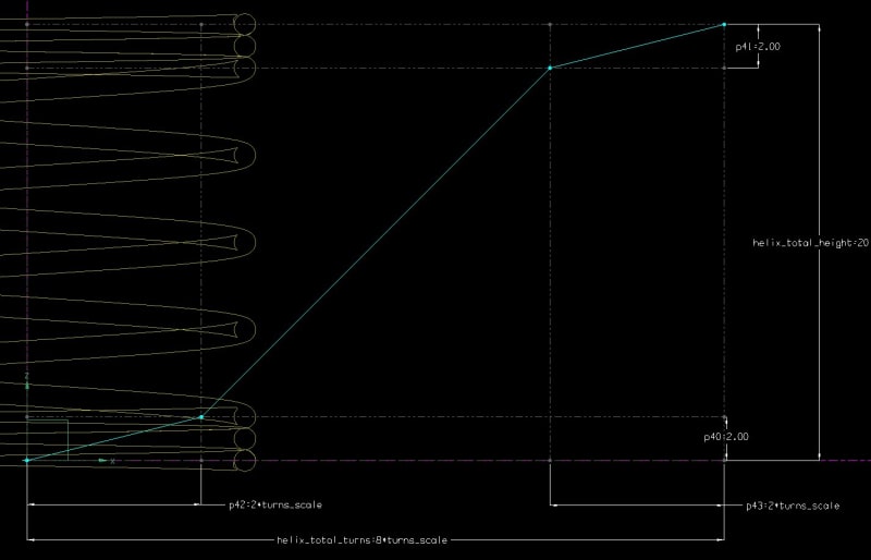

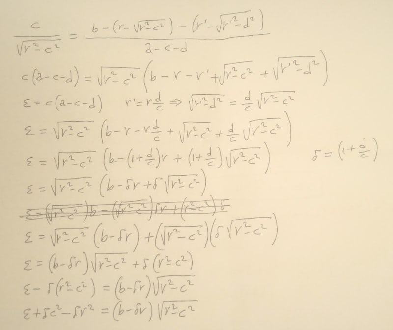

Hi Javad
My post is the solution you need
for your helix problem.
the difference between it and the
one that in photos is that the
3 lines for zt are replaced by equation.
Thank you.

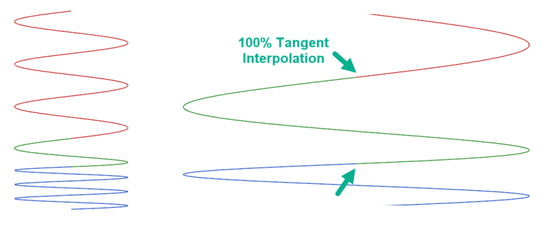

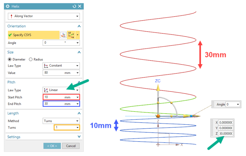

also last night i noticed that the helix height growth is completely linear. so i used the linear pitch law type in helix command and built the curve i wanted. the 3rd helix in between is fully tangent. also according to previous constant helix curves parameters, i wrote a simple equation and got the same result.
you can look at attached images and file.

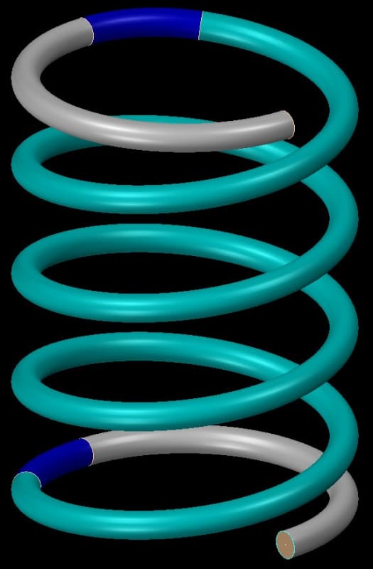

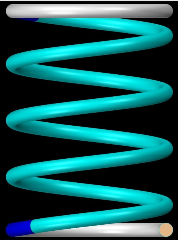

Here's the second spring
It's more complicated. For his mathematics
I used the Internet and took a lot of challenge and time
To reach the result that is attached to the file in this post
If you succeed in tracking and understanding the file what is good
If not I myself will have to relearn it
Before I can answer any question that arise.

Hi again
i used two helix curves with constant pitches:
Red Helix
Blue Helix
variable pitch helix curves are in 2 methods and one of them may be used:
green helix is created using linear law type with illustrated values
magenta helix used an equation
I attached screen shots for you, so i hope you can follow along and create helical curves in NX11
best regards
javad

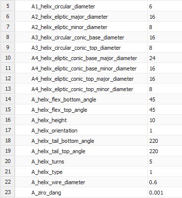

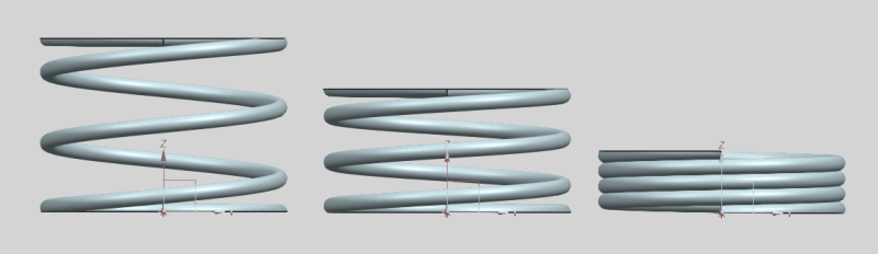

A Documentation for the flat smouth top and bottom helix
for any one that have interest.
This helix is verstile and can be changed by the A_xxx variables to
1. circular helix
2. circular conic helix
3. eliptic helix
4. eliptic conic helix
