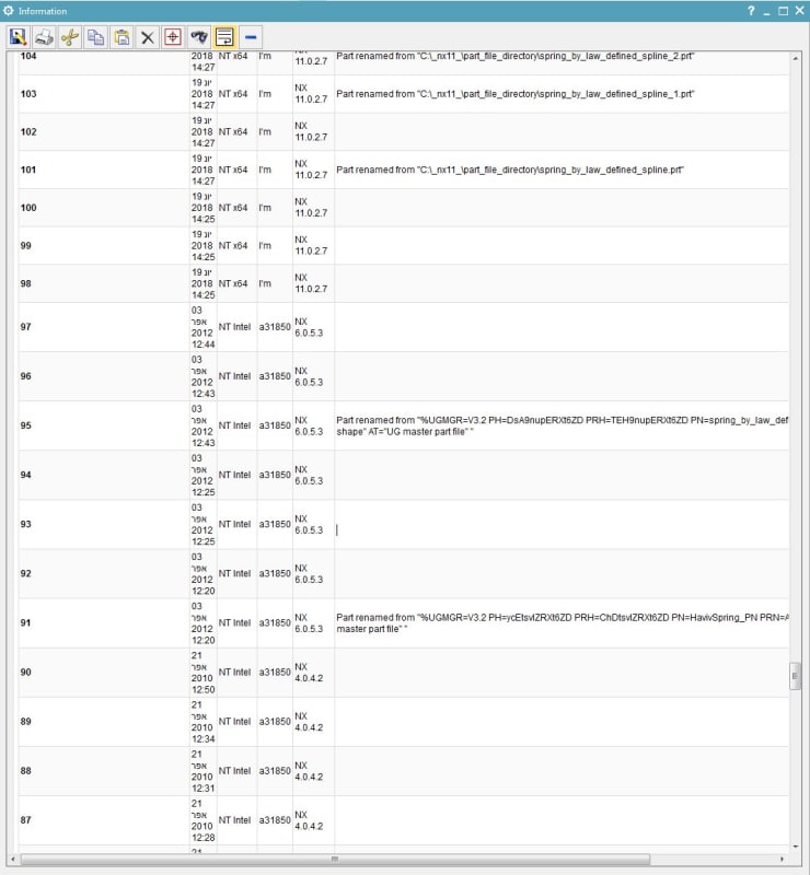

Hi Tomas and thank you.
this helix was built in nx6 before some years and I post it here according the
question of this thread. (all in math)
Above I also posted an example of by law helix.
and this is a 4 helix at once.
Thank you again.
