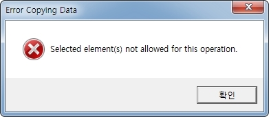

I made the script to copy & paste special a body. It works very good only in same part.
I'd like to do from another part bodies.
Also I have no idea this : "Selected element(s) not allowed for this operation.".
Could you explain me what is wrong?

Hi Ferdo. Thank you for your answer.
But I'm sorry to not understand your reply.
Could you explain again with my script?
Code:
Dim InputObjectType(0)
Dim InputDocType(0)
Dim ActDocSel
Set ActiveDoc = CATIA.ActiveDocument
Set ActDocSel = ActiveDoc.Selection
ActDocSel.Clear
InputObjectType(0)= "Body"
Status = ActDocSel.SelectElement2(InputObjectType, "Select a Body.", True)
  If (Status = "Cancel") or (Status = "Undo") then Exit Sub
ActDocSel.Copy
InputDocType(0) = "Part"
Result = ActDocSel.SelectElement2(InputDocType, "Select a CATPart.", True)
Set SelectedPart = ActDocSel.Item(1).Value
Set WorkDoc = CATIA.Documents.Item(SelectedPart.name+".CATPart")
'ActDocSel.PasteSpecial "CATPrtResult"
ActDocSel.PasteSpecial "CATPrtResultWithOutLink"
You have to activate the target CATPart, after copying your body....
Set partDocument1 = documents1.Item("The_name_of_your_target.CATPart")
Dim editPart
Set editPart = partDocument1
CATIA.StartWorkbench("PrtCfg")
editPart.Activate()' '''''make the part active (highlight blue colour)
selection1.PasteSpecial "CATPrtResult" ' ----- Perform Paste As Result With Link

Hi, Ferdo,
Thank you for your reply.
It works very well!!
