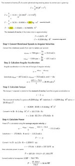

Hello, I wanted to see if it would be possible to create an anti-lock brake rotor that would unlock on non-braking events to free up the power it takes to spin them to speed.
But my numbers seem pretty high. My calculation
Taking a typical Shelby GT500 brake rotor(I know you all have these laying around like me), consider this brake Rotor laying flat on your screen, where z-axis is coming out of the screen, and rotating, with an outer radius is 7.5”, inner radius is 4.5”, thickness is 1.25” and mass of 31.4 lbs, what is the inertia? Then find the torque and horsepower to accelerate the brake rotor to a target rotational speed of 700 rpm to 1500 rpm in 4 seconds about its z-axis. (Basically a tire diameter of 28.5" to get wheel rpm from 60mph to 130mph, gives 700rpm to 1500rpm wheel/rotor speed.
So as the title states I got 175 ft-lb and 36Hp. But torque acting on the hub given a 3.55 rear diff gear ratio, we'll get 49ft-lb and 10.14 Hp is what the engine needs if you go through a 1:1 4th gear ratio. Multiply this by 4 wheels (say rear wheels have 75% smaller brake rotors), you're looking at 172 ft-lb and 35Hp from the engine just to turn the brake rotors. Seems reasonable?

I still don't understand the problem statement. EVs have already solved this with regenerative braking. You lose energy getting the brake rotor up to the same rotational speed as the rest of the wheel. Yes. You can also regain nearly all of that energy with very little added complexity if you use a hybrid powertrain.
What problem do you think this is solving? Heavy unsprung mass? Change materials, increase cooling, go lighter. Fuel efficiency? Same deal. Complexity? Uh, no. wrong direction. Lack of vehicle acceleration performance? Again, make it lighter, change gear ratios... add a hybrid system.
Step 1 with (all?) engineering problems is to ask yourself: what problem does the solution address? Step 2 is to get into the tradeoffs. To me, this is as much of a potentially good idea as an aircraft with a lead fuselage. Could you do it? Sure. Should you do it? Probably not.

This is trying to squeeze 1% more performance out of a race car over a couple percent of the race at the expense of having no brakes when the complicated mechanism fails. It is to do this by removing the inertia of the brake rotors from the drive train during acceleration like those stupid free-wheeling spinner hubcaps do. Unlike the spinner hubcaps, this seeks to re-attach them for braking, but that means waiting for the rotors to come up to speed, then locking them to the axle and only then can the brakes be applied.

I suspect Brembo has already built a better compromise than this. Something to do with ultralight carbon/carbon discs and 1-piece calipers. It's pretty wild watching those test videos of F1 brake simulators. The disc goes beyond red-hot and back in less than a few seconds. Fantastic heat dissipation, from an impressively light rotor.
And ultimately, you're trying to reduce unsprung mass. That's higher priority than the rotational inertia. So I'm still confused about this whole thought exercise.
