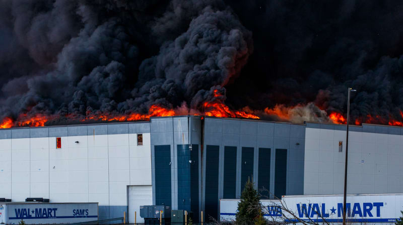

As a structural engineer who has worked on similar structures, I have always assumed that this level of fire was a thing of the past in these types of structures. It will be interesting to see what comes out of the investigation and if this will lead to changes in the industry. These mega warehouses are popping up at a significant pace.
A large, non-compartmentalized structure with vertical stacks of cardboard and plastics, some containing lithium batteries? I'm surprised this isn't a regular occurrence.
But where's the sprinkler system?

Unless it was a deluge system I can't see it denting this sort of fire.

If they sorted,picked and pulled orders in this facility, their would likely be serveral thousand polyethylene bins in use. Walmart also prefers that their vendors use HDPE pallets. In my experience the use of in rack sprinklers varies widely, not sure if Walmart had a corporate standard.
The fire started on "a third floor mezzanine", according to a reporter in the first link.
Are lithium batteries stored in third floor mezzanines?
How about polyethylene bins. Are they up on a third floor mezzanine?
HDPE pallets?
Usually, what is stored in third floor mezzanines is piles and piles of paper records that can't be gotten rid of.

Started on a third floor mezzanine may also mean first noticed on a third floor mezzanine. That is generally where one would first notice a fire. High above the source of heat where the smoke accumulates.

Judging by the way the collapsing wall panels pancaked the semi-trailers parked outside, it is probably a concrete tilt-up wall with a metal deck roof. If I was a fire fighter I would loath this type of construction.
OHIOMatt - I vote in favor of adding more engineered fire protections to these warehouses. It seems like a reasonable enhancement for the building code. Perhaps also some new structural integrity requirements for fire, so the tilt-up panels can survive longer and not pose such a threat to firefighters. Maybe in conjunction with some enhanced integrity requirements for tornado? I suspect Wal-Mart, Amazon etc. can afford it, but will take a push by the industry to make it happen.
I am sure that insurance companies are looking at this long and hard.
After all they can enforce rules that others might find difficult.
I was a sprinkler designer in a past life. Storage is a nightmare, and its not because of the code, its the owners that make it damn near impossible sometime.
First, sprinkler systems are designed to suppress a fire so that occupants can get out and the local fire department can respond. That being said, a number of fires are controlled or suppressed by a single sprinkler head.
Second, design requirements are well codified by NFPA and additional recommendations are available in the FM Global Data Sheets, all informed by actual losses in the field. For larger facilities like this it is not unheard of for the insurance company to require compliance with FM Data Sheets or internal standards that go above and beyond code minimum.
Problem is everything is based on a design fire. I only know what the owner tells me is going to be stored there. After the CO is granted who the hell knows if the owner is going to be aware that a change in use invalidates my original design? Also a lot of the storage designs are based on strict layouts with aisles and shelving dimensions to avoid obstructing sprinkler sprays. I cant walk into a local tire shop without seeing tires stacked in the aisles, which are marked with paint for a reason... And the design densities for rubber storage are pretty hefty since depending on how you stack tires there is a lot of shielded space for a fire to grow. Also regularly see tires stacked in a manner that don't match the approved methods in the figures in the code, but I doubt anyone working in the tire shop even knows what NFPA is.
Then there is always the fire where the last tech to touch the system left the control valve on the water supply off, rendering the system useless.
The answer isn't more stringent design codes, its more stringent enforcement of the assumptions that the design codes are based on.
