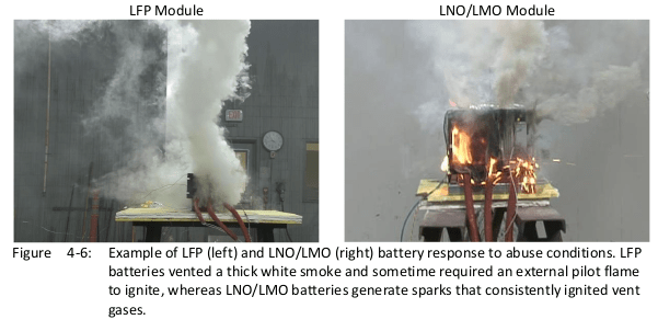

Has the FM test been repeated with the ignition source being a remotely shorted (ie internally overheated) battery pack? You might get the same action by using a restive charcoal igniter embedded in the center of the bottom crate, then packed with a load of batteries. The video is impressive, but the after photo shows minimal involvement of the internals of the battery packs.

LCREP, this picture (in the report you shared) is exactly what I was considering should be one of the test scenarios. IE forcing a thermal runaway is much different from igniting the cardboard container.

LFP (often called Lifepo4) chemistry has lower energy density and current density but is both safer and will tolerate more charge/discharge cycles.
