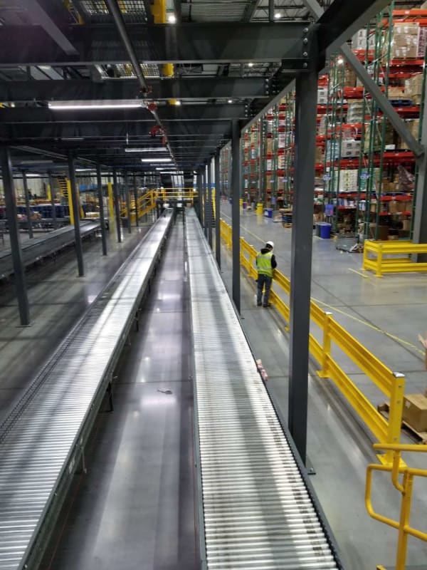

This is what it looked like inside apparently
plainfield_allpoints_parkway_9590_walmart_ecommerce_fulfillment_centerhtml_mwlnda.jpg
You can see a sprinkler line under that platform.
I'm more interested in what the in rack protection was for the shelving on the right and the ceiling level protection since the reported origin is a third level mezzanine.
