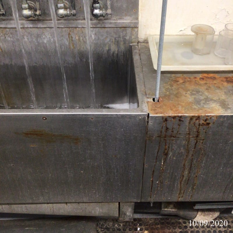

Does anyone have an explanation for this corrosion?
This application is a remodel of a water treatment laboratory. The equipment is all new. The trough sampling sinks are made from Gauge 316L-2B stainless steel. The other items like the drawer pulls and safety eyewash are 316 stainless steel.
The trough sinks are used for water quality control and the water runs continuously. The trough sinks have the worst corrosion. As you move farther away in the room, the corrosion on the other fixtures lessems.
October 2020, photos were taken of new rusting stainless-steel products in the Control Lab. New stainless-steel eyewashes, new stainless-steel tub sink, and new stainless-steel cabinet handles were all showing significant signs of rust.
March 8th – 10th, 2021 the new stainless steel trough sinks were installed and were not cleaned or polished at that time. Within a week, these items began showing signs of
rusting.
On April 5th, 2021, the new stainless steel trough sinks were cleaned and polished along with other existing stainless-steel products. Within a week, they began showing signs of rusting again.
On May 27th, 2021, Owner polished the new stainless-steel trough sinks. Within a week, they began showing signs of rusting again and photos of the current condition of the new stainless steel trough sinks are included.

Give some of the worst area an abrasive cleaning (flap wheel or scotchbrite) and see how deep the pitting is.
If there is not deep pitting (only a few thousandths of an inch) then cleaning properly (abrasive, caustic, acid, rinse) should work.

It could also be related to the surface getting smeared when they did the final 'polish' and trapping stuff in the smears. Anything that traps moisture on this surface will aggravate this issue, in addition to iron contamination.
I always recommend that people do an abrasive treatmetn first, it helps open up any smears and it helps remove other surface contamination.
I'm going to throw out something totally different: When I've seen damage like that in 316, I've found the corrosion is really from stress corrosion cracking that formed from chloride exposure. The SCC exhibited in the form of localized pitting when observed macroscopically. I note that the sink outside surface as well as all of the new hardware all exhibit significant corrosion damage while the inside is largely free of it, probably from the constant rinsing away of the sink interior during use.
An alternate explanation is the grade of steel is not 316L but a grade much less resistant to pitting corrosion in a water lab. Given the degree of damage, is it possible to remove some of the corroded material and send it to a lab to investigate? They could examine corrosion mode (i.e. SCC or pitting, for example), look for contaminants like chlorides that would drive corrosion, and confirm base material.

This is potable water with 20 mg/L of chlorides. Not significant chlorides.

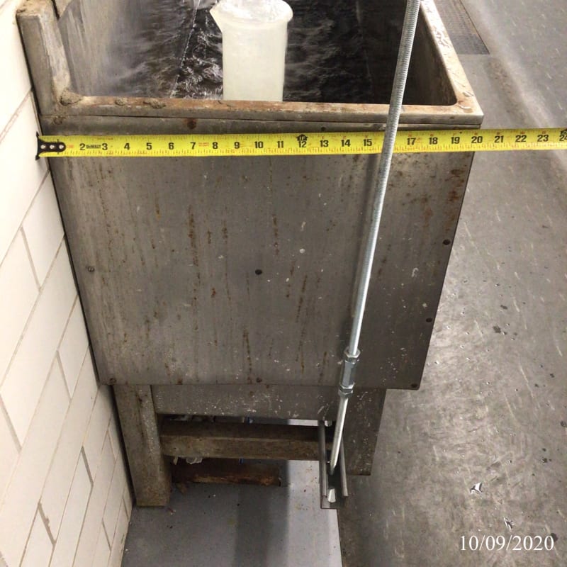

Somebody kept telling me that the original sink that was installed for 60 years did not have corrosion like this. I wasn't here so I went back and found some pictures. Well surprise, surprise.
EdStainless mentioned it in his first post. Not a good application for stainless. Why would a consultant specify the same material when it is clearly not suited for the application?

The issue with exposed surfaces is that as the water evaporates away, the concentration of chlorides increases substantially.
As TBE said, the spots that form when water drops evaporate will be 26% salt. Wet/dry is the killer application for SS.
