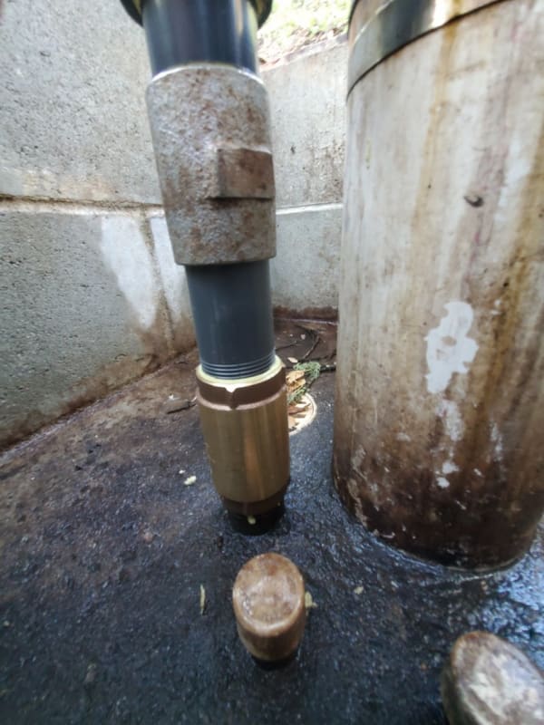

This is the checkvalve.

Next I removed the hardware from the other side of the Tee. The hosebib and the pressure gauge in case they provided 'flex' to allow the flutter.
No improvement.
Removed gorgeous Ring Necked Snake from well pit.
Pulled the downstream pipe from the check-valve then had to drain it because of the 100psi behind it. Couldn't depress it because of the 100lbs pushing on it. Hammered a screwdriver into one edge. Water geysered. Left and came back 30 minutes later, no change. Drove it in further. 10 minutes... Drove a second one in on the other side of the gate. Had to lay there with my hand over it holding in the screw drivers and guiding the considerable flow away from everything for 35 minutes until it rather quickly dropped to a trickle over about 10 seconds.

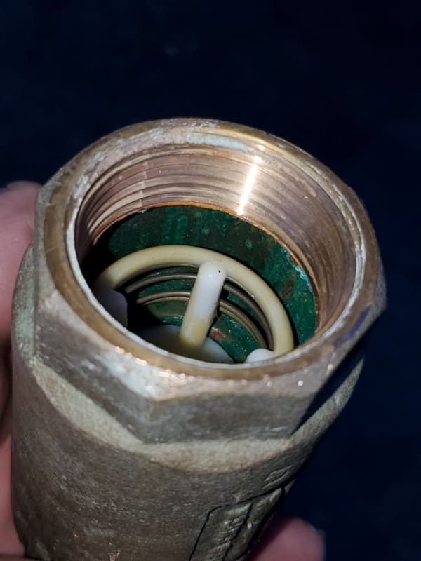

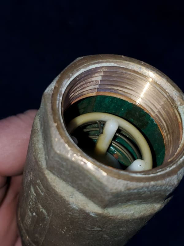

Pulled the check and installed a new one. Played musical pipe nipples and couplings for a while until we got it the exact right length to allow mate-up of the union halves. Fired up the well and blessed silence. Could hear nothing but felt a slight vibration. Current eventually returned to 10.9A (instead of 10.8) New check-valve opens a few PSI easier. More flow - another 1/10A
Looking at the removed CV the spring appeared to have been broken. It was a pretty stout spring wrapped in the body perimeter and clearly had a layup anomaly. I suspect that made one side have a lower tension causing a pressure and hence flow asymmetry across its face that caused the flutter.

Photo of the broken valve?

Good result and knowledge for some, agree photo would be nice just to round off the discussion.
