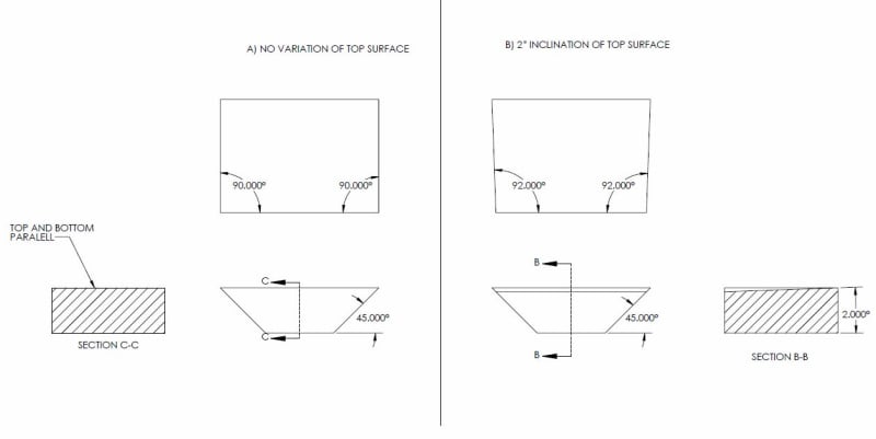

However, unfortunately, based on my experience I can envision a case that the vendor or manufacturing department might insist on changing the drawing so that the right edge is utilized as the measurement origin, because the easiest solution for them technically for inspection might be supporting the part by the edge against a flat face in a fixture which is perpendicular to datum plane B and measuring from it. The downside of it is that the edge is probably not a functional feature in assembly and not very reliable for DOF constraints.
A datum feature/datum feature simulator or even a Datum Reference Frame is not the same thing as a measurement origin. Per our discussion above, the measurement origin can be anywhere - as long as it is consistent between measurements. These can be coincident, however they do not have to be.
I would recommend against using a sharp edge like this unless absolutely necessary, especially if it is not actually a functional feature. I would say it will constrain DOF reliably, however unless strictly controlled it likely will not result in repeatable measurements. This is because of edge break requirements (ie; deburring), or if unbroken with burrs/flashing, and unless extreme care is taken - contacting the edge on a gauge or any other surface will have an impact on measurement (think dulling of a knife blade). These may not be a concern with wide open tolerances, but definitely something to consider.

I mostly meant that it won't constrain the DOF in the same way as the flat surfaces would in assembly (and I am assuming here that the flat surfaces constrain the part in the application assembly). The meaning of it is that the part might end up oriented differently than the design intent probably imposes.
I would tend to agree with this. Add this to the list of reasons that an edge like this shouldn't be utilized as a datum feature/target. See below - this edge is actually defined by the intersection of two surfaces and as such is affected by variations in both. In addition to the reasons I mentioned, this would impose additional unexpected variation during measurement. The figure is simplified, but the concept translates - apologies for the rough nature, I drew it up quickly. Note that a 2deg inclination of the top surface has correlated directly to a 2deg inclination of the edge (*90deg vs 92deg - imagine this to represent the datum target edge C in Yuyu28's example), even though the angle of the surface (*45deg - imagine this to represent the datum feature C in the same example) is unchanged.

*Added angle references to tie into my figure

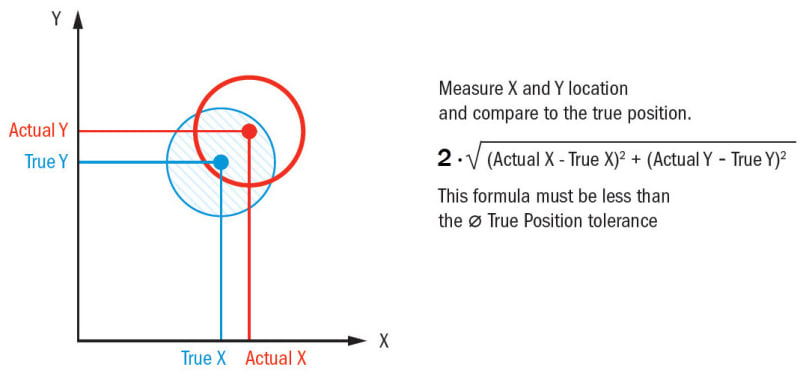

I've been asking myself the same question. But recording, and usually also reporting the measured coordinates is how I've seen this done and taught in various sources. A few examples are:
An explanatory figure from gdtbasics.com:
A suggested measurement report from a tip on some other GD&T training website (It can be argued that this source is unreliable as they suggest validation according to axis interpretation for an MMC tolerance specification):

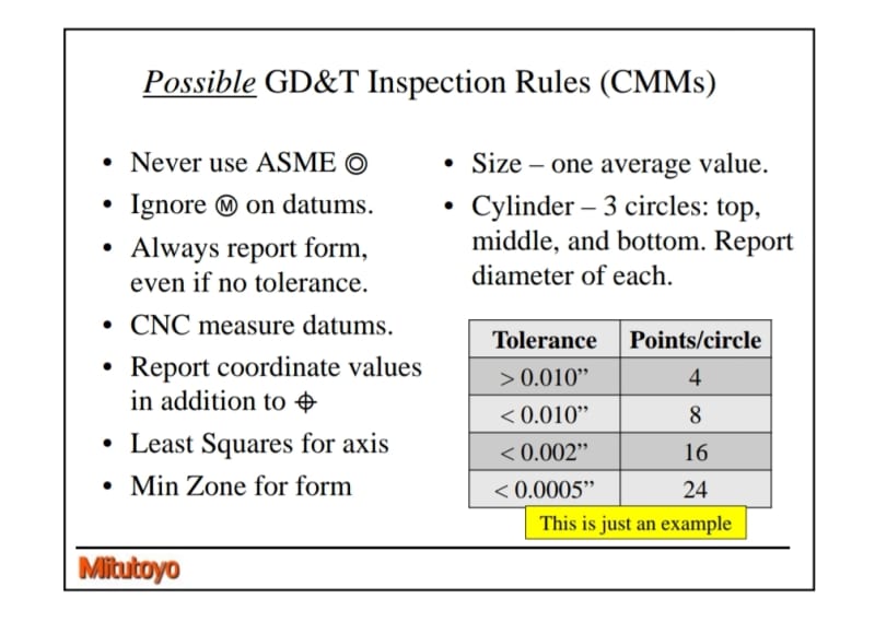

A more reliable source is CMM measurement guidelines from Mitutoyo. Notice the part that recommends/guides to report coordinates in addition to the actual value of position.
