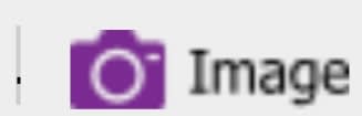

I think the Eng-Tips Insert Image function works fairly well. Click on the Camera icon
and select the image file, click Done.
Your image is inserted directly into your text. Everyone will see exactly what you are trying to discuss without all the static of Imgur links.
Test image:
