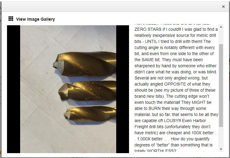

Hi, I bought a set of drill bits from Amazon:
Hymnorq 1.0 to 10mm Metric Jobber Twist Drill Bits Set of 19pcs Titanium Coated HSS 4241, Straight Shank for General Purpose in Wood Plastic and Soft Metal Sheet
To my disappointment, they could not even drill IKEA wood! How come?
Are there any specifications that I should pay attention to?
@SnTMan The ones I got cannot even make a hole. Paired with the IKEA drill, I could just make a small dent. Those drill bits I used at schools could drill woods and aluminum. These cannot even make a hole. Unbelievable!
Resharpen the drill size diameter you need
And resharpen it. Look up the relief required in the machinist hand book
Or look up the relief for wood.
If steel is 5 degrees relief, grind a 10 degree relief.
Use a simple protractor to measure it.

Real drill bits are made from quality tool steel such as m2 or m4, and the mfg heat treats them with care. The grinding and sharpening are done precise.
And makes a big difference when trying to drill precise holes. When the job is important. It pays to buy the best.

BreadboardPerson and everybody else, something is way wrong here. You should be able to make a hole in IKEA (pressed ?) wood with just about any piece of metal, even your Amazon drill set. You can chuck a nail in a drill and make a hole in wood. Why don't you give some detail.
What size hole? How deep? What drill? How fast you running it? What is an IKEA drill? What is IKEA wood? BTW, 1 inch = 25.4 mm.
I don't doubt your drill set may not be the highest quality available, but c'mon, really.
Sntman
I suspect cheap junk with the wrong drill geometry not sharpen correctly.

is this the drill? Have you tried a different drill? 7.2V is wimpier than my 19.2V drill, with 2 cells shorted; mine could not drill through standard 2x4; but same bit with a fresh battery in the drill worked perfectly

Well there's this review:
Could explain it all :)
Well there we go
Some probably got lucky and had decent
Sharpening.
"Some probably got lucky and had decent Sharpening."
