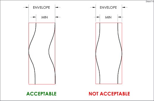

Please consider a design intent where the variation on the width of a feature of size is more important than the measured value itself. For example, a part feature needs to be of width 4.1mm Max and 3.9mm Min, but the variation on that feature width can only be within 0.07. For example, if the width along the actual produced feature varies between 4.03 and 4.1 the part is acceptable. But If the width varies between 3.95 and 4.05 the part should be rejected as the variation is within 0.1 which is more than 0.07.
How would you specify this requirement in accordance with ASME Y14.5 (any revision year)? Would you attempt to achieve this requirement by a geometrical control or combination of controls (size and parallelism? Some sort of profile? Size and form tolerances? Size and runout tolerances?) Or would you specify 4+-0.1 and write a custom note describing the variation requirement?

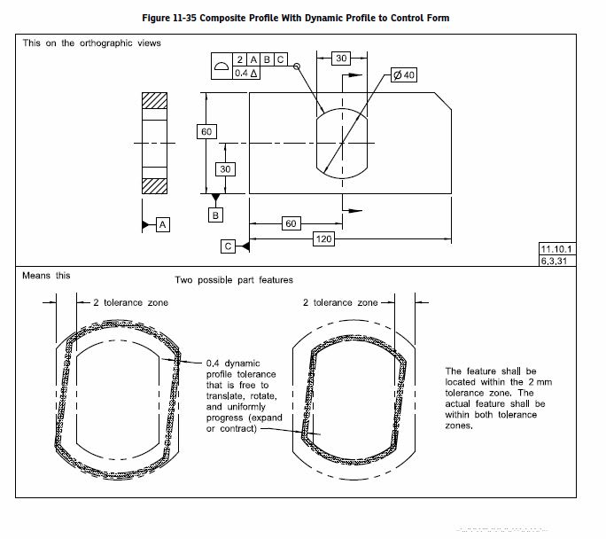

Using the newest standard (Y14.5-2018), the "dynamic profile" concept might be a good fit for you. Can't give a detailed reply right now, but that's my initial thought...

Theres might be a few different ways to skin this cat, but I'm with JP - 2019's new dynamic profile concept seems like a good fit. If the two planar surfaces could be held parallel to a common DRF then that could be an option as well.

I try to provide some help to the designers with the drawing. From talking to them it seems that they mainly care about width variation/ thickness uniformity, whatever you prefer to call it. I conclude that parallelism is not the best representation of this design intent but I might be wrong. For example, a wavy part can be very uniform in thickness but fail parallelism inspection when being put on a granite slab on one side and running a dial indicator on the other side. Your thoughts?

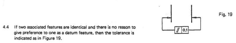

CheckerHater, out of curiosity, about that past practice of parallelism without datum - how was that inspected?
It was not "without datum" - it was just irrelevant, which side to chose as a datum.
I guess it also introduced some ambiguity - is it enough if it satisfied on one side, or it must work on both sides? (Which may explain it becoming obsolete)
For what its worth, I agree - hence my previous statement.
CH,
It occurs to me that something like your datumless parallelism could possibly be achieved with dynamic profile. That is, if its allowed to be applied to non-continuous surfaces (ie: two separate, parallel sides), which is possible with a standard profile tolerance (4-22 in 2009 and 7-27 in 2018).
If we are looking at something like this:
I don't think there is standard solution. Probably have to resort to verbal description.
CH,
I believe thats exactly what we're looking at, hence why I previously provided OP with a few options for custom notes that could be applied.
FYI my comment about dynamic profile was sort of tangential to the discussion - it would not fit OP's application, it was only meant to be a response to the fact that as you stated the "datumless parallelism" is no longer explicitly allowed however may be possible in another form with the introduction of dynamic profile in 2018.
