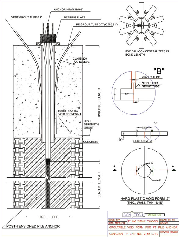

The rock anchored piles actually have pancake shaped voids on the top. So when the anchors are post tensioned the concrete cap and piles can be drawn tight and the anchor bond to the earth can be mobilized. They fill them with grout through tubes afterwards. You can see the tubes in one of the photos above. Pretty neat stuff.
