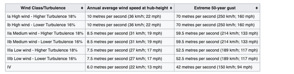

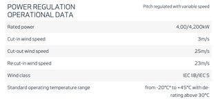

So the windmills in question are designed for
where
Maybe it was a hot day or accumulated thermal damage - we do get fry an egg on your car's roof days here. Class II wind gust is 160 km/h for a 1 year gust
