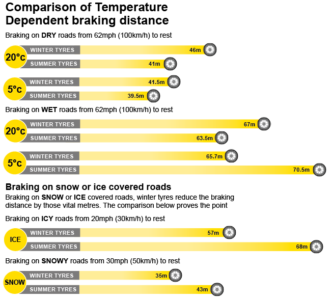

Here's some numbers for winter and summer tires,

Those snow and ice numbers are almost meaningless without a temperature.
Hmm, not specified. I can't find anything more detailed either.
I would suspect ice covered roads are at or under 0*C. Same with snow covered roads.
No they aren't apparently.
The snow acts as insulation and ground heat can take bottom layer above freezing.
And salt keeps the fluid below freezing liquid under it....
According to a Finnish bloke at work....
Just passing on what he said...
It seems the Finnish have a whole science centred round it. They also do tracked vehicle performance as well.

Barrie is located north of Toronto, south of Georgian Bay. It is located in Ontario's snow belt, and it is where lots of Torontonians go to ski. It snows way more there than it does here.
LOL, the roads sure as hell won't be 20*C and ice covered. Who cares if the road is -20*C or -2*C or 0.5*C, the snow and ice covered test results will still favor the winter tire.
They are, and the security requirements at their development centres are more stringent than for Defence!
It actually matters quite a lot.
If there's a water film between tire and ice it's a lot more slippery.
Sun, contact pressure and heat from the tire can all contribute to a water film, but at some point there isn't enough heat to let the film happen.
100%.
As a wet-sider in Washington state, we get snow and ice on the road when temperatures are right around 0 C. The snow/packed snow/ice that forms almost always has a film of water atop it, and the result is slicker than snot on teflon. I used to regularly have to drive over the mountains to the east side of the state for work, where winter temperatures were much colder, typically -10 C or colder. Snow there is sticky, and it creaks and squeaks when you walk on it or drive on it. Having grown up used to wet snow, cold snow is easy. But coming over the pass back to the wet side, where the snow gets wet - I always move over to the truck lane on the 3 main upgrades, where the sand and chains from trucks break down the ice, even though the lane speed is much slower. Faster vehicles who obviously don't know the difference always blow past on the upgrade, and then spin out when they hit their brakes on the subsequent downgrade.
