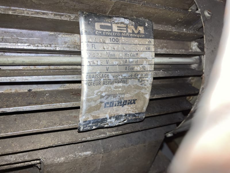

Evening all
I’ve got a 2.6kw induction motor, inside the motor cap I’ve got 12 terminals, the machine it came off had a 2 speed setting, all the cables went back to a multipole switch for 1450 or 2800. I’m trying to use the motor from a single phase in 3 phase out VFD.
Tested the motor out and I seem to have 6 pairs all with about equal resistances, my question is 1 is it possible to run this motor delta for use on the VFD, 2 - how best can I identify which pairs I need to use to wire delta for use with my VFD
THANKS

If it's a 2 speed motor then it will have two independent sets of windings. That would naturally have 6 leads. The fact that yours has 12 leads me to believe it has a high/low voltage option as well. Pairs will be wired in series or parallel depending on input voltage. Identify the windings for the high speed and connect those to your VFD. Tape off the remaining connections.
A picture of the nameplate will get you a more accurate answer.

The motor does not appear to be 2 speed or dual voltage from the nameplate. That is strange.
Some people will use the 12 lead configuration to indirectly attain 2 speeds, by using a Wye-Delta or Part Winding arrangement but not solely as a starting scheme, they leave it in the first stage as the low. So really it is two TORQUES, then the load determines the speed that it runs at with the lower torque. This however only works with centrifugal machines like pumps and fans.

With 1:2 speed, it's a Dahlander winding as below.
Delta is low speed (supply at 1U 1V 1W and 2U 2V 2W open).
Two Wye is high speed (supply at 2U 2V 2W and 1U 1V 1W shorted).
Tricky part is identifying the leads if they are not marked.

Since you have marked the leads, restore the original connections to the multi speed switch, apply direct voltage without VFD as before to check the both the speeds and then insert the VFD between the supply and the switch.

Actually you don't.
There is no way to tell if a motor is internally connected wye or delta from the supply wires. The inverter cannot tell a wye motor from a delta motor.
I once had to connect a consequent pole (Dahlander) motor with all the markings missing.
I removed the rotor and with a battery and a compass I identified each winding location and polarity by energizing a winding and then finding the physical location and polarity with the compass.
