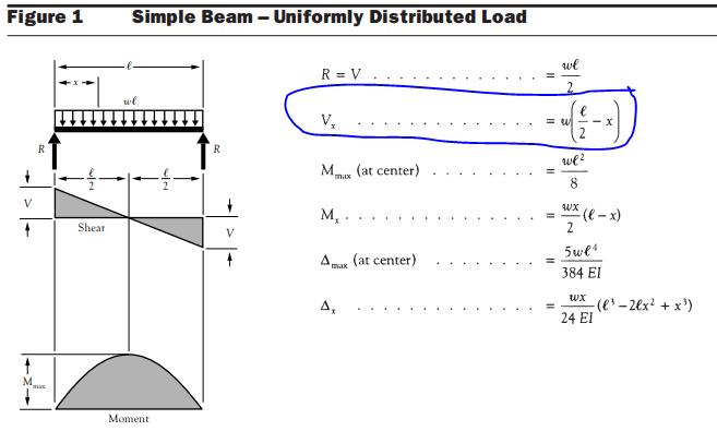

I have a question as to why every example of a beam splice shows the load in tension as shown in this link:
Kootk from this forum gave the solution to use a beam splice in this thread but no calculation example:
The only place I have found to talk about the load perpendicular to grain is this website which used a prescriptive approach:

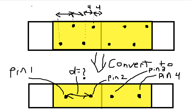

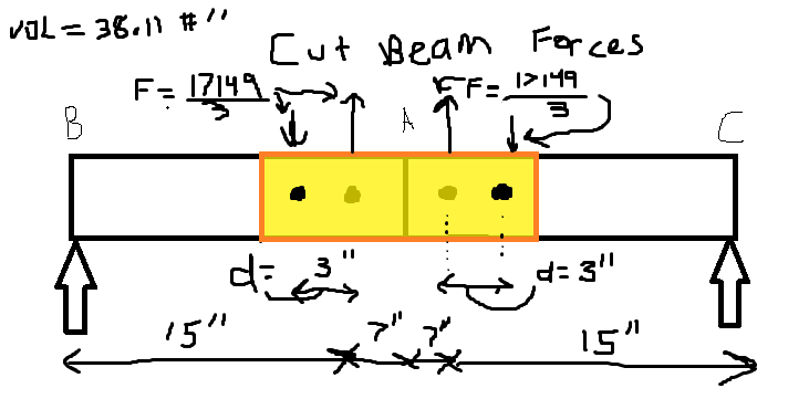

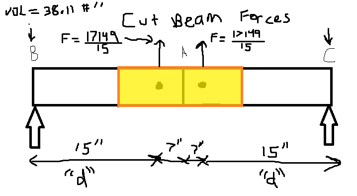

So my question is, why isn't there an example of the calculation shown in link one ( but with a uniform distributed load along the splice(such as the modified picture attached)?
