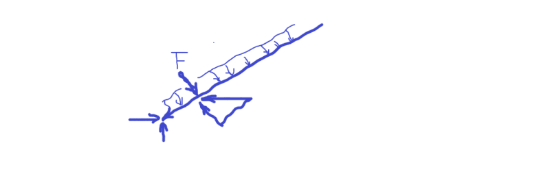

Am I making mistake in resolving the force below?
Buleek: For your situation, I'd use plenty of nails for that plywood sheeting, especially for the bottom two rows. Then that "beam effect" of the bottom roof plywood rows can be a distinct advantage. End walls should be sheeting if possible to help take that thrust from the roof.. This of course in addition to beefing up connections for that horizontal tie. Ya can't compute this stuff, but we know it can help.
Retired13
The key to your free body diagram is what happens to the force at the top of the rafter. You have to have a reaction up there. If it can’t sink, then the forces are all vertical and there is no outward force at the heel.
And I’d indicate gravity as down rather than toward the plane of the roof.
JLNJ,
No wind?
But, you are correct. The force along the rafter will be taking care by the tie as shear in the connection. Thus, no outward force will occur.
